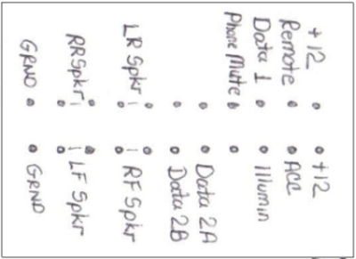

ranger svo
Copper - Posts: 70
Joined: July 04, 2007
Posted: July 14, 2007 at 9:03 PM / IP Logged
Here is what I have in my notes for 05 06 Dodge PU  A couple of things to note here, if  Data 1 is present then Data 2a and 2b are not. The reverse is also true. I have not seen a dimmer wire on these trucks yet so I am gonna assume that dimmer control is data controlled.
Also, if Data 1 is present,  I have not seen a remote turn on wire yet.
If you see or notice anything please let me know. So far I have only worked on 10 or 12 of these trucks.

jurish
Member - Posts: 6
Joined: June 29, 2004
Posted: July 17, 2007 at 4:07 PM / IP Logged
Is that the stereo pinout or the sirius receiver pinout?
Looks like too many pins for the sirius box.
