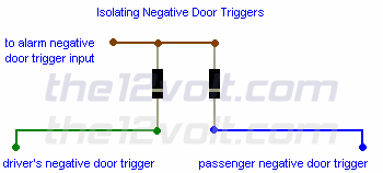

I picked up the door pins in the driverside kick panel.   I am not sure about isolated diodes?
Is your alarm hooked to "all" of the pins (wires) If it is you WILL need to isolate them with diodes. UNLESS you are using a posative trigger. To isolate this one wire posative trigger you will need a relay.
code alarm ca680 remote shows open door -- posted image.
You say the hornis hooked to the alarm, is the siren also going off when the horn is?
