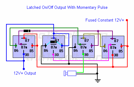

rfid keyed double/push starter button -- posted image. Latched On/Off Output Using a Single Momentary Pulse
Similar to the momentary to constant configuration above, we can engage and disengage the latched output with a single pulse from a switch or an output from an alarm or remote keyless entry. The first pulse from the switch will engage the latch. The next pulse from the switch will disengage the latch.
The above is a latched relay setup.  The switch at the bottom of the picture allows the relays to be turned on  and then another touch of the switch turns them off.
You will need to leave the switch for killing the system.  You will also need to parallel the output of the RFID box with the switch.

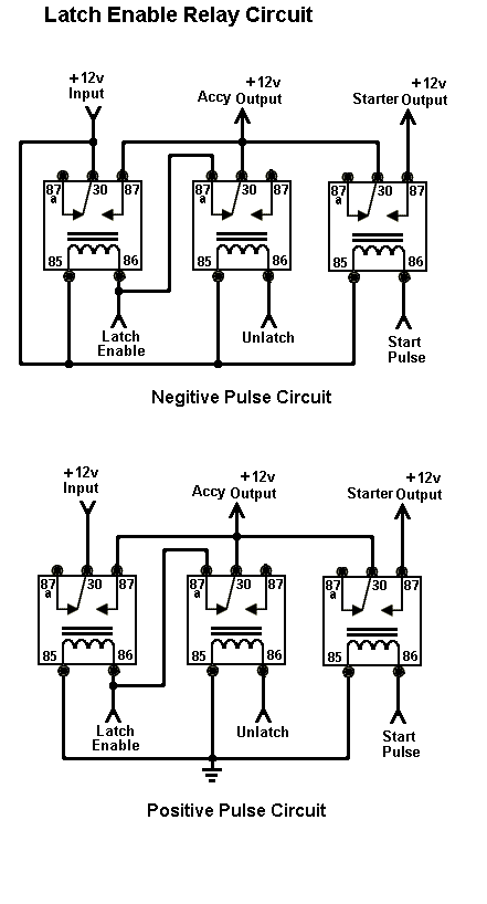

Posted: August 12, 2007 at 7:49 PM / IP Logged
Here is what I came up with. This is for Positive Pulse Starter
John DeRosa (Hotwaterwizard)
Stockton California
When in doubt, try it out !

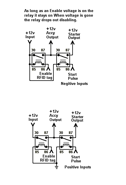

Posted: August 13, 2007 at 8:07 AM / IP Logged
Stockton California

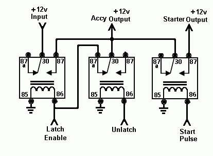

hotwaterwizard
Silver - Posts: 1,350
Joined: December 11, 2003
Posted: August 13, 2007 at 8:44 AM / IP Logged
