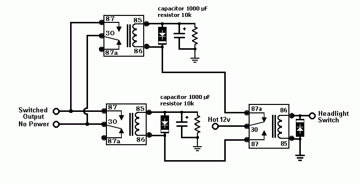

This is what I came up with.
Two Constant to Momentary Relay Circuits powered by the relay that will be flipped from one position to the other by the Headlight circuit.
popup headlight trigger from dipped beam -- posted image.

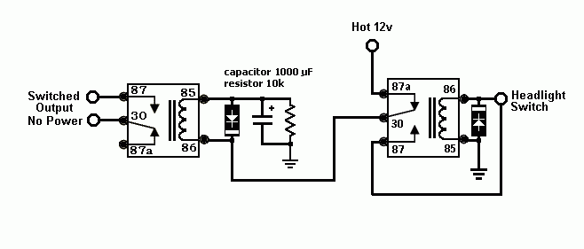

Here is another one I came up with that uses fewer components.
The only draw back of these circuits is they may get out of sequence. You may need to keep the push button across the output just incase they are reversed. You would need to push the button as a Reset to synchronize the circuit.

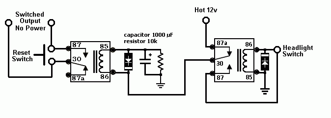

Reset Switch Added

Posted: July 29, 2007 at 1:20 PM / IP Logged
The Diodes are there to stop the EMF Spike as the magnetic field on the coil colapses.
ANY 1 AMP DIODE OR BETTER WILL WORK.

Posted: July 31, 2007 at 8:10 AM / IP Logged
hotwaterwizard wrote:
Reset Switch Added
Hotwaterwizard, this second setup might not switch because the cap is left energized by the 87A contact and doesn't get a chance to reset in the short time the headlight switch relay is between the NO/NC positions.
Maybe use some solid state buffering?
