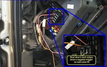

Here's a quick pic of the left side fusebox in which you'll find the PDM fuse. Ignore the doorlock references, they weren't meant for you.

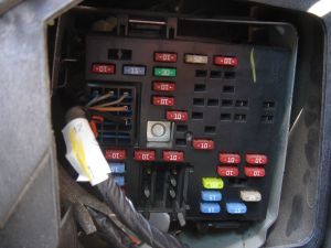

I think my problem is something else, my fuse box doesn’t have that fuse.
03 silverado wiring -- posted image.
Now what?
