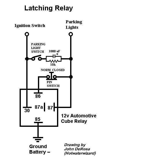

You need to latch the lights and unlatch them with the pin switch. It would be easier if you use a seperate Alarm switch for this purpose. park light goes off when you open door -- posted image.

^^^ That will not work in my application. sorry
I was thinking more like, when the ignition is it will power a relay to supply the light switch (latched)
So the lights can be turned on and off using the light switch once the ignition came on and latched. But if I foret my lights on, when i switch off my ignition, the lights will still be on...and only go off after I open my door. Also, if the car is running and I open my door, the lights should remain on if they are on.

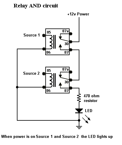

This circuit could be used a relay AND Circuit.
