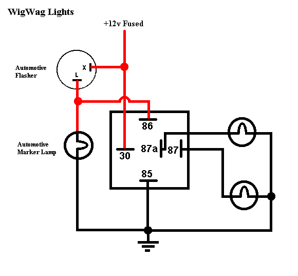

hotwaterwizard
Silver - Posts: 1,350
Joined: December 11, 2003
Posted: August 30, 2007 at 9:43 PM / IP Logged
How about one relay?
alternating headlights -- posted image.
John DeRosa (Hotwaterwizard)
Stockton California
When in doubt, try it out !

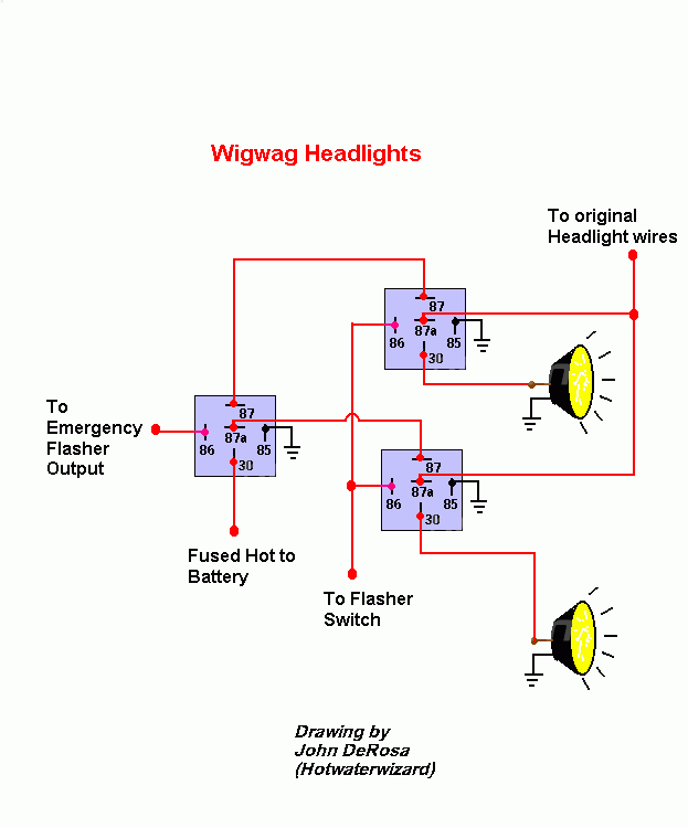

hotwaterwizard
Posted: August 30, 2007 at 10:35 PM / IP Logged
Here is one using your Emergency Flasher Circuit
