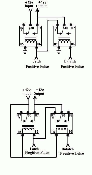

latching relay with input -- posted image.

By adding another relay you can get the requested Results.

Will this 3 relay setup drain the battery in either latched or unlatched state?

As it sits in the unlatched state it will not drain the battery It only does when a pulse is applied and the output is latched.

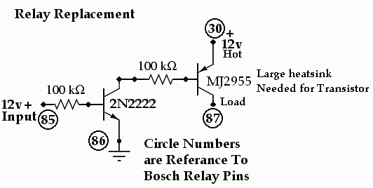

You can use what's called a bistable relay to switch it on or off without a constant power draw in either state; they just need a single pulse to change positions.
They're pricier than regular monostable relays though, so depending on what you're looking to switch, you might be better off just using a transistor to turn your device on and off. Solid state devices won't draw power like relays do, and you can get them to handle pretty large currents.
