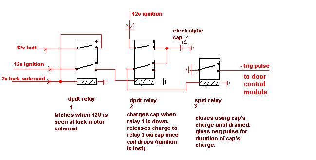

how's this look? it came to me this morning.. should be able to rebuild using transistors though - this is silly to use relays for a low-current circuit like this.. any suggestions/improvements/things I've missed?
thanks!

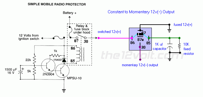

Add that Circuit with a Constant to momentary and you got it.  Circuit modified for negitive pulse output.

Looking this over though... the first 1/2 of this circuit (radio protector) would handle the delay portion, and would send 12v + to the 2nd portion after a few seconds of ignition being on; that part is cool. (And adjustable using different resistors and caps to extend that delay).   So far so good...
but then, the 2nd portion of the circuit (constant to momentary) would pulse a negative briefly to the door unlock portion as I see it, as soon as that delay had expired.
this would mean that after a few seconds of seeing ignition, the system would UNLOCK the doors, rather than waiting to LOSE ignition.
What has to happen here, is that that negative pulse is only to appear once, and briefly , once that 12V is LOST.   Have I mis-read something?
Thanks again!

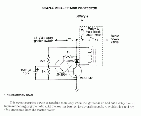

Power-Off Time Delay Relay http://ourworld.compuserve.com/homepages/Bill_Bowden/page2.htm
The two circuits below illustrate opening a relay contact a short time after the ignition or ligh switch is turned off. The capacitor is charged and the relay is closed when the voltage at the diode anode rises to +12 volts. The circuit on the left is a common collector or emitter follower and has the advantage of one less part since a resistor is not needed in series with the transistor base. However the voltage across the relay coil will be two diode drops less than the supply voltage, or about 11 volts for a 12.5 volt input. The common emitter configuration on the right offers the advantage of the full supply voltage across the load for most of the delay time, which makes the relay pull-in and drop-out voltages less of a concern but requires an extra resistor in series with transistor base. The common emitter (circuit on the right) is the better circuit since the series base resistor can be selected to obtain the desired delay time whereas the capacitor must be selected for the common collector (or an additional resistor used in parallel with the capacitor). The time delay for the common emitter will be approximately 3 time constants or 3*R*C. The capacitor/resistor values can be worked out from the relay coil current and transistor gain. For example a 120 ohm relay coil will draw 100 mA at 12 volts and assumming a transistor gain of 30, the base current will be 100/30 = 3 mA. The voltage across the resistor will be the supply voltage minus two diode drops or 12-1.4 = 10.6. The resistor value will be the voltage/current = 10.6/0.003 = 3533 or about 3.6K. The capacitor value for a 15 second delay will be 15/3R = 1327 uF. We can use a standard 1000 uF capacitor and increase the resistor proportionally to get 15 seconds.

The circuit would look something like this.
Delay off with Pulse timer to follow
