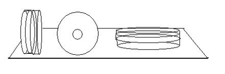

To give you a clear picture of how magnetic fields interact, look at the 90 degree rule:  that two magnetic fields that are opposed at ninety degrees have the least interaction.  So, for example, if your sub is facing outwards in the normal fashion and the coaxial is facing straight up, the two magnets would be opposed by ninety degrees.
Get several inches away from each other and it doesn't matter.
These three coils are each 90 degrees from the other two coils:
how close can magnets be to one another? -- posted image.

That's true, stevdart, but in the case of a static magnetic field, such as that in which a loudspeaker's voicecoil is immersed, interaction won't have any effect on the other driver whatsoever, whether the fields are right on top of each other or not.
In the case of a dynamic field, like those of a coil in a crossover, and the fact that an external magnetic field will change the value of the coil, (and it will change - dynamically, altering the values - dynamically, introducing distortions - dynamically) it is vital that the coils be placed the way you have shown them.
