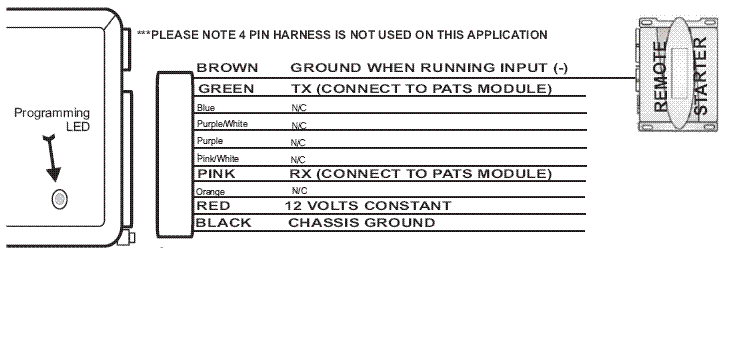

Is your module looks like this, if so, did you connect the red to +12 or to the ign wire ?
mazda cx 7 pkf 3 not working -- posted image.

Red wire is connected to +12 constant.
