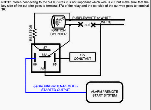

im gonna be putting a r/s in a lumina my question is that there is a chip in the key. how would i wire a resistor into tihe r/s? thanks in advanced. to get the bypass for that car is 79.99 so that why im asking here.

you do not need the $79.99 bypass, all you need to do is meter the resitance of the vats chip in your key, get that size resistor and with the use of a relay place inline on a cut vats wire, you can search for more info.

1998 chevrolet lumina, remote start -- posted image.
