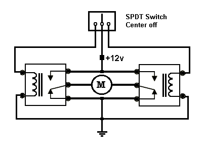

I have a 2 wire powered ram that I wish to control with a NC change over switch and relays. I need the polarity of the feed to reverse when the switch outputs are selected.

Well I've solved it, thanks or all your help I don't know how I would have managed with out you folks. polarity change over switch -- posted image.

Thanks John that is pretty much what I ended up with.
