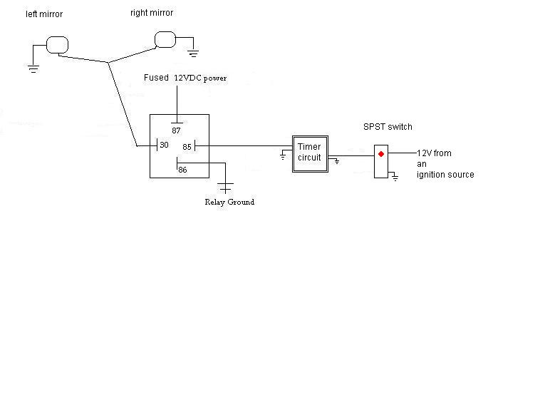

Hey guys i was wondering if this would work?
which heated mirror switch? - Page 2 -- posted image.
Posted: October 29, 2007 at 11:14 AM / IP Logged
Some of the timer circuits contain an output relay giving about 5-10amps. If your heated mirrors draw less than this you wont need the sec ond relay. If you decide to keep the relay your wiring layout is correct

i've just e-mailed the company to find out how much these heating elements draw.

well i got a response lol check this out...
Dear Mr. XXXXXXXX,
The amps on the 3801 are 12v.
Please contact a Speedy Glass in your area for the cost and part number 3801.
