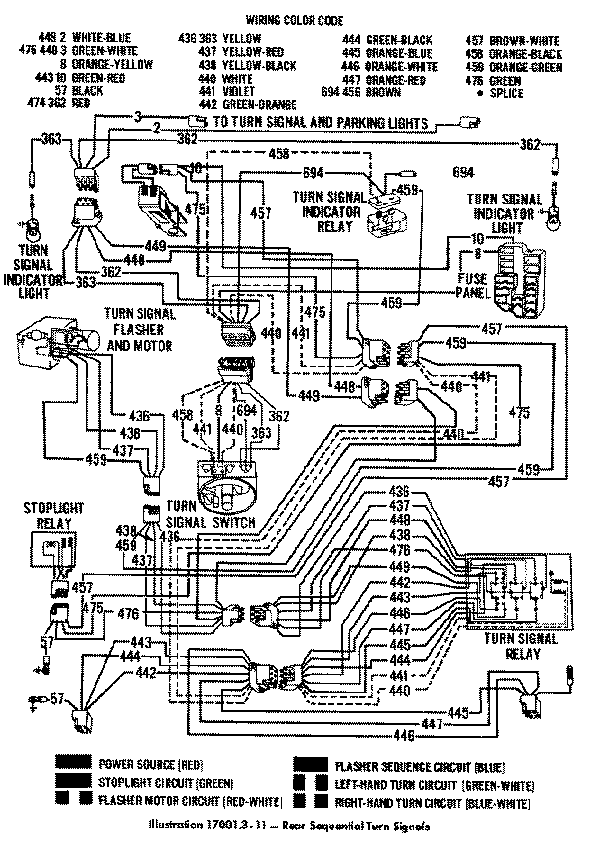

I am trying to find some kind of current sensing relay that is adjustable.  My dilemma is that I have a 1967 Ford Thunderbird.  The car was designed with a sequential turn signal system.  Part of the circuit is a relay located under the dashboard which opens when the current draw reaches a certain point and closes when it falls off again.  This open and closing of the relay flashes the dashboard turn signal indicators.  The way that the relay is supposed to work is that the turn signal system lights the front and rear turn signal bulbs, and then adds the center rear bulb, and then finally the third.  Once all bulbs are lighted, the current draw is supposed to trip the relay to open, thus turning off the dash indicator momentarily.  When the flasher motor has turned off all bulbs, the relay closes, thus lighting the dash indicator, and then the cycle repeats.
The problem is that as these cars age, some portion of the current draw is lost and not enough current flows through the (original) relay to trigger it to open the circuit.  Thus, the dash indicators never flash off, they dim progressively as there is more draw from the battery.  This problem is prevelant is nearly all 60's Thunderbirds with sequential flashers.
So, what i am trying to locate is a similar relay but with an adjustment control to it that I can decrease the amount of voltage that has to flow through the relay to open its circuit.
Any ideas would be great.  If you need further information I will do my best to provide it to get to a solution.

Sounds like you could put together an electronic circuit using a voltage comparator and relay driver to do it.
With a low sensing resistance in line with the lighting power and the normally closed contacts of the turn signal relay, it could be set up so that it would turn on when the voltage across the current sense resistor goes above your threshold point (when all three lights come on).
Once it toggles, the output goes to a transistor driver for the relay. Probably want to add a small delay after it trips, so the third lamp stays on for a bit instead of immediately turning back off. The relay energizes at that point, switching the contact paths.
The relay would open up the connection path and turn the lights off, and the current through the sense resistor drops back down to zero, turning off the comparator again. Rinse and repeat.

current sensing relay? -- posted image.
