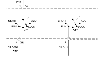

Try power up ign2 1 sec before ign1. Some people will say it doesn't matter but look at the following diagram. You had a very weird situation, every avenue needs to be explored, don't you agree ?

Thanks mooonliter, that is the next thing I will try. This whole situation stinks, so i am willing to try anyting right now. Of course, the worst part about this is that after i clear the code, it takes a little while before it is triggered again. Then it stays on until it is cleared, it won't go away on its own.
