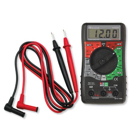

Ok heres the Question.  I am installing a remote start  on a 93 civic si (SOHC Vtec) I hav tested tach signal wire to the tach test wire( blue wire ds under windshield single wire with connector)  I have tried the Blue wire at the distributor and i have to much fibreglass and other(CUSTOM) things covering the computer (so thats outta the question)  NOTHING has any change on the DMM 0v on DMM b4 probing wire and 0v while probing.   Has anyone encountered this or know what would cause this?  I mean doesnt the computer need that signal to run?  Car runs strong and hard no PROB`s no engine light and the engine light DOES work if there is a failure?

Do you have your DMM set to AC voltage?

autostart ct 3260, 93 civic si? -- posted image.Its on BAT 6v on that  DMM
The dark red section right above the green BAT section immediately to the right of the OFF position is AC voltage, put the switch to the lowest value in the AC range and test again.

Ok so the odd time the wire right at the distributor will spit out a signal but its not constant and its not always there..... the reading when it is is 30.0 at 200acv any ideas??

Ok "IT WORKS" the wire inside the distributor was disconnected and was shaking with engine vibration making contact momentarily. Re-connected wire and now my factory tach works i then Re-programmed the R/S and set it into ready mode pulled the key out got out turned car of with remote and VRROOOOM fired right up no starter drag at all.  My first install and it would have went smooth if it wasnt for that dang tach wire  THNKS for all the help and "happy installs"
