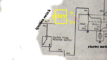

Ok so I hope to install an alarm system/car starter (scytek visionguard 8000-m) on my car (1997 Pontiac Sunfire, manual) tomorrow.  I was just wondering exactly to how I would do the clutch safety switch.  The instructions give two different options and I dont know which is better suited for my car: open circuit, or closed circuit.  Personally, I have a hunch its closed circuit.  So before I go chopping up my starting system I just want to verify with someone. My first picture is the diagram for open and closed circuit the manual has, and the second picture is what I believe I need to do.  If I am wrong could someone please correct me.  Thank you!
clutch safety switch -- posted image.
sorry for picture quality...good ol 30kb limit.  anyways so ya. does that last picture look right?
Thank you so much for your help in advance!

Connect your remote starter "starter output" directly to the purple wire on the clutch switch.
Your clutch is now bypassed. Remote start's EVERY TIME. If your remote start isn't manual safe, it will start in gear.
I don't know the skyteck line, and usually look before I post.... but I trust you, and hope your smart.clutch safety switch -- posted image.
