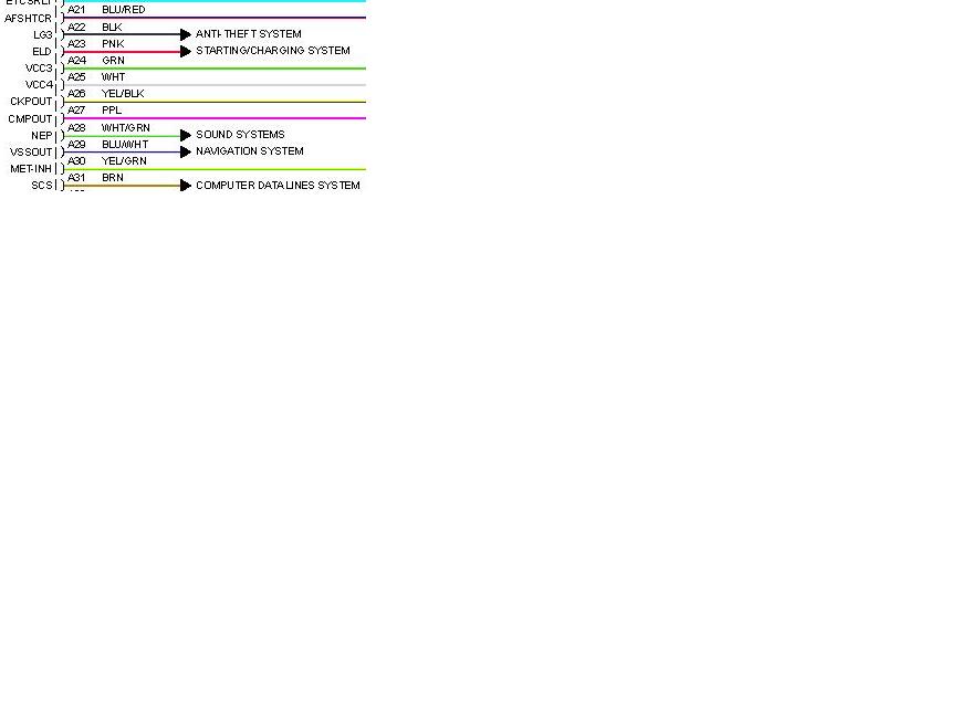

here is a diagram you will find these wire next to them look for the blue /white
2007 honda odyssey nav info -- posted image.

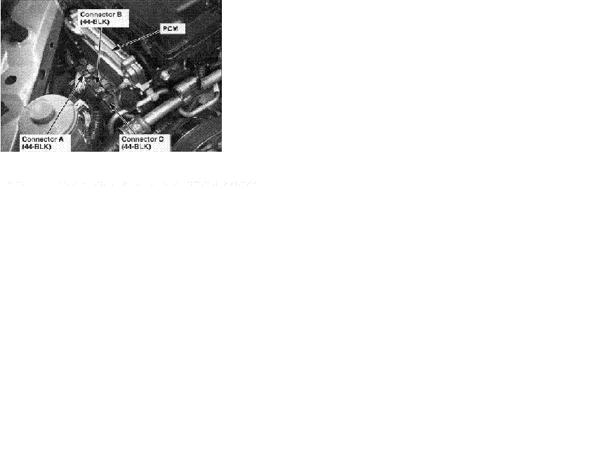

Bnluis
Silver - Posts: 578
Joined: December 24, 2002
Posted: November 16, 2007 at 6:49 PM / IP Logged
