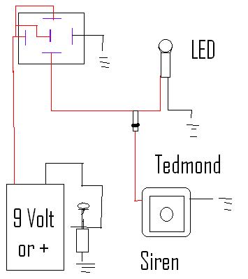

you could just use a pin switch, batt and some wire. Im just really spitting here, not sure if it would work or well for ur application. Maybe some1 can elaborate on this and make it a better version. check out the diagram. sorry that it looks crappy, its a paint drawing :p
need some insite, tool box security -- posted image.,
well what i drew shows the relay control. . When toolbox lid is closed, the led begins to flash because the relay is N/C and siren is not enabled. When the relay switches to N/O because coils energized, continuity between 70 and 30 allows siren to blare or buzz, as the N/C doesnt allow the led to flash. what i recomend is using some sort of power switch so u can disarm the system before opening, like cut the postive from the power source. Im not sure if 9volts will have enough power to energize a relay. Maybe if you use a 12volt power supply; then yes or any battery close to 12v. note: ground the LED and SIREN negative straight to the battery. Ground relay wire to the pin switch, shows ground when open.

dont forget a diode across the relay terminal 85 86 =D
