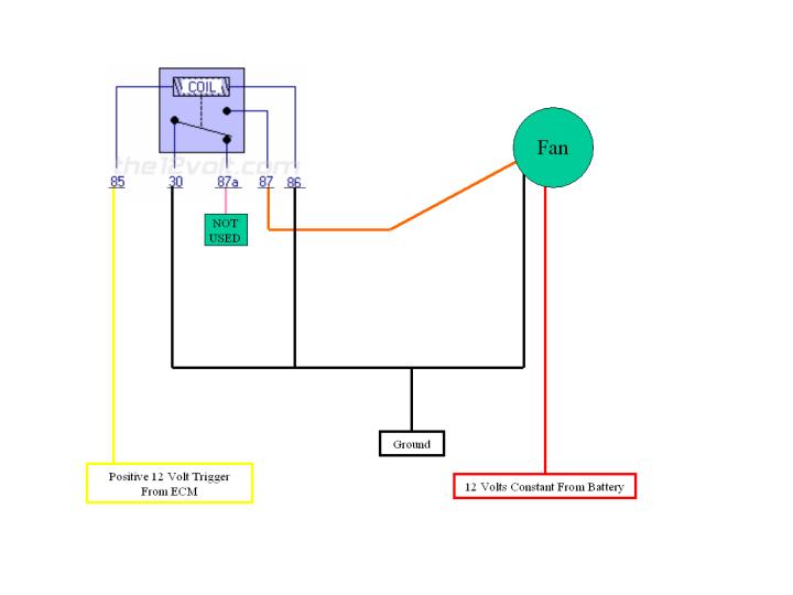

Posted: November 24, 2007 at 4:28 PM / IP Logged
i have a fan that im trying to wireup in my car.  The fan has to have the neg. disabled  for it to work.  I would like to use the 12 volt power source, from the ecm to disable the neg. side of  the fan.  Is this possible with a relay?  The fan has a constant 12v , and a neg. ground, and has a neg. trigger.

How the fan works, that im putting in the car,  has full time power going to it., off a 12volt source.  It has2 individual grounds ,  one from the battery and one from the ecm.  In order for the fan to come on,  the one from the ecm must be disabled.  The fan is out of a toyoto.  Its a dual fan set up.  The ecm which is in a mustang uses a 12v to trigger.  the fan.,  the stock fan.  I need the wire from the 12v out of the ecm  to hold a ground until it  reaches its temp.  , then it activates the fans.

ok here you go...
12v trigger to disable neg output -- posted image.

You just confused me real bad !  12v trigger to disable neg output -- posted image.
Do you need to utalize the Positive 12v output from the ECM to produce a Negitive output for the new fan?
If so a relay can be used as an interface.
