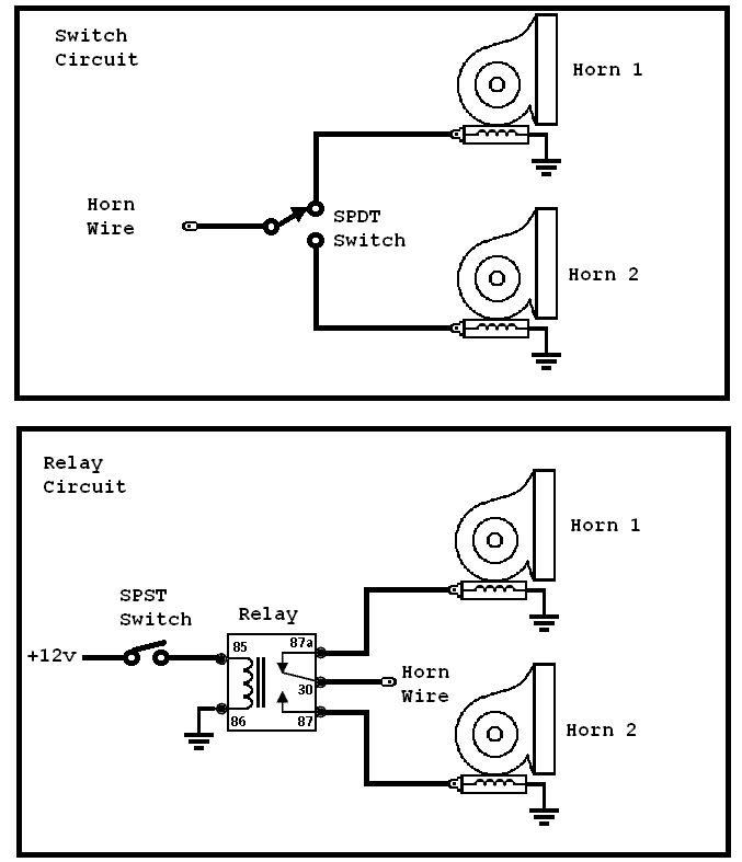

use a standard 5 connector relay and a regular on/off switch

Here are 2 circuits One with just a switch and the other using a Relay

so which one would be better? would they both make it so I can push the horn on my steering wheel and depending on which one the switch is on, be able to switch between the train horn and then regular horn ?

Posted: November 30, 2007 at 8:00 AM / IP Logged
The switch is better to me because no extra power source is needed.
The switch has to be able to handle the current from the horn.

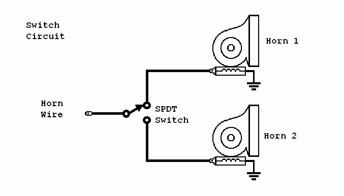

Here is how you do it.
pull the wire off of the existing horn. Put that wire to the center post on the switch.
now run one side of the switch to the horn and the last post on the switch goes to the second horn.

zsupra1221
Member - Posts: 36
Joined: November 25, 2007
Posted: November 30, 2007 at 8:31 AM / IP Logged
wow thanks for your help that was perfect!
