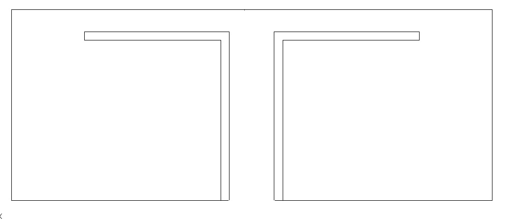

How would I turn this enclosure into one with a single port in the center of the enclosure?

You'll probably run out of box volume before you get enough line. Why not just build it per the plans?

I don't really want to do it i just want to know how to mathmatically.
Platinum - Posts: 13,725
Posted: December 11, 2007 at 4:28 PM / IP Logged

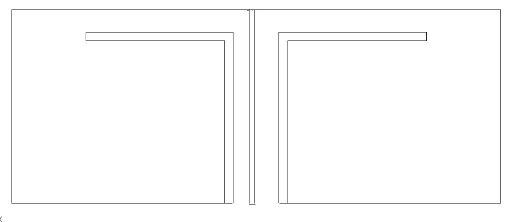

This would be 2 ports but they are in the middle
You couldn't.  But you could certainly design a dual-driver single ported enclosure using those speakers.

I guess what I really need to know is when i designed an enclosure in WinISD I got the best results for an enclosure that is 3 cubic foot big and 32 Hz for a tuning frequency. If I wanted to put a port in the middle how would I go about doing that? I know how to do it around the sides but I wanted to know how to put it in the middle?

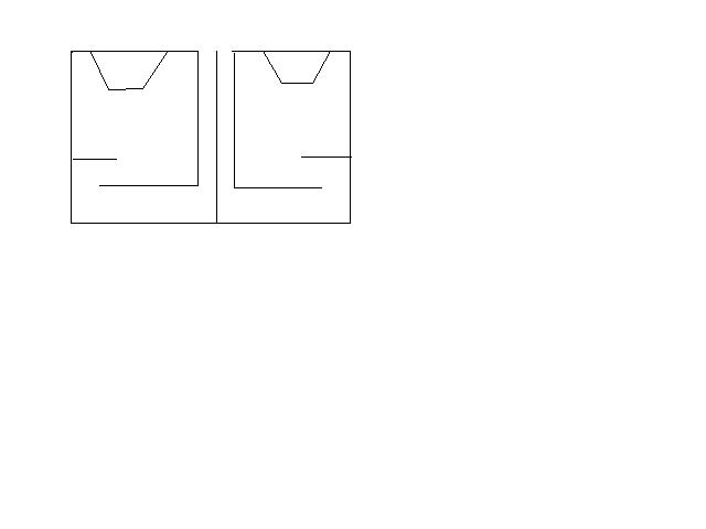

What i'm looking for is something that looks like this. How would the port length work and how wide is the port going to be when it hits the back wall?

DYohn wrote:
That's what your latest pic is, a dual-driver single ported enclosure. Usually it's best to have each sub in thier own enclosure, like first pic you showed. The reason is because if one driver was to fail, the other wouldn't be affected by all the extra airspace (for both of them).
You would first have to answer this:
How long must the port be while keeping port noise in check?  And, is this length a few inches less than the inside depth of the box?
If yes, you would fit two baffles at the center of the box that extend from top to bottom.  The distance between the baffles is slot opening width, just the same as if you put the port along the side of the box.  You would need a few inches of free space at the end of the port.  The box is a single chamber, not divided.
But if the port must be longer than the box can be deep, you can't do it in the center with one single port.  You would instead use a dual chamber box with dual ports as I am an idiot illustrated, or put the port off to one side.
I don't accept your last illustration as a proper vented enclosure.  It's a muddy mix between a single chamber and dual chamber and I wouldn't count on the port response accuracy.  My opinion is that a multi-driver single chamber enclosure must share airspace other than that which is comprised of port airspace.

How about adding one more piece of wood and have it look like this.
