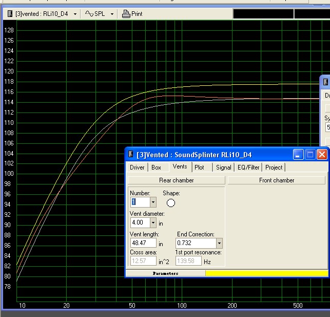

I don't know how to take the information that I see on that Soundsplinter site.  With the very small box size recommendations, port length is astronomical...certainly not feasable at 8 feet long.  Yet that is what they claim is the optimal car response:  .45 cu ft tuned to 27 Hz.  Even doubling box size out of the "optimal" size but still in "acceptable" range at 1 cu ft, port length with only 12.56 square inches of opening (4" port, which I would consider minimal) is still a very long 43.5 ".  Generally, we see much larger enclosures for vented boxes and thus shorter port lengths.
I edited this to add:  I took a look at this pair of subs in a .9 cu ft net airspace box using WinISD.  That's going with the optimal recommendation set forth on the site, and tuned to 27 Hz.  It's a nice rolloff that looks a lot like a sealed box response.  There is no problem with port noise using just one 4" port for the two-woofer box.  And there is no problem with cone excursion.  I gave the program a maximum 1000 watts for the two subs and I don't see a problem with either one.  It looks like a good sounding sub system (see yellow response line below).
Port length is long, but using only 12.56 square inches of opening for the entire box brings the length down to 48.5 inches.  You may want to either use a round port or build a square port and incorporate that into the box.  The length of the port doesn't work in a typical situation that you might see where the port just goes back to the rear of the box and turns a little bit.  This port will turn a few times to get that 4' length into the box.  Keep this in mind, though:  you will save a great amount of space by using PVC round port instead of building the port from box MDF material, with this much length to deal with.  It's a small box if you think only in terms of net airspace, but a much bigger box when the port is included within.
Of course, be sure to deduct port volume as well as woofer displacement from total box airspace to arrive at net airspace.
