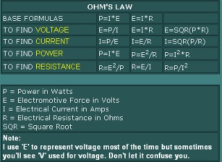

Now, use Ohm's Law to find out what voltage output you are seeking.  Let's use the power output of 298.66 watts per the birth sheet.  Here is an Ohm's Law table (from BCAE1.com):
Ohm's Law when using power supply -- posted image.
"If you know two values you can find a third value using Ohm's Law."  What values do you know (or assume to know) in your scenario?  Do you know amperage?  Power output?  Impedance, or resistance?  You know power output (298.66 watts) and you know impedance (4 ohms).  You don't know amperage, or current.  Look at the formula on the chart that uses those two known values to find voltage:  E = SQR (P X R).  P X R is 298.66 X 4, or 1194.64.  The square root of 1194.64 is 34.56.  That is the voltage that you will seek by touching your DMM leads to the speaker output terminals that the sub is connected to (but disconnect the sub first).
