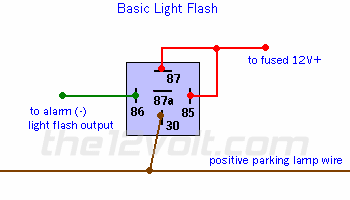

i have a hornet remote start and keyless entry. i have the remote start working but i need help with the parking lights. the alarm requires a relay if it is a positive trigger i belive. i think i have the correct wire it should  be brown but when i check it with a meter the volts drop to 0 when they are turned on.                1. First qustion is how to wire the parking lights up to the relay and how big of a relay do i need.   2. Second question is can some one give me a wiring diagram because the one i got from here appears to be wrong with some of the wires.    3. Third is about the door locks what color wires do i need and do i need more relays if so how big of relays and how many.                            THE car is a 94 grand am  se 4 door with a v6 .

The car should have positive trigger locks and parking lights. Check the parking light wire again; if it doesn't test out right look for the wire at the switch. Door lock wires should be light blue(lock) and black(unlock) or light blue(lock) and white(unlock). Look for them in the harness coming from the driver's door boot. If your remote start has positive lock outputs from the brain you won't need relays and you can ignore the info below.
Use relays rated at 10 amps or higher.

 Here you go this should help you out, use S.P.D.T Relays 30AMP  (Single Pole Double Throw) These are standerd automotve relays. You will Also need 1amp Diodes id you are hooking up door triggers.

|       ITEM      |     WIRE COLOR     |POL|       WIRE LOCATION        |
|        12V       |            red                 |+     |       ignition harness            |
|    STARTER|          yellow              |+      |      ignition harness            |
|      IGNITION|          pink                  |+      |     ignition harness            |
|  SECOND IGNITION|      blue                |+    |        ignition harness            |
|        ACCESSORY|orange              |+  |ignition harness            |
|       POWER LOCK|lt. blue            |+  |gray conn R of e-brake *3   |
|     POWER UNLOCK|white               |+  |gray conn R of e-brake *3   |
| PARKING LIGHTS +|brown               |   |steering column             |
|       HEADLIGHTS|tan(low)  green(hi) |+  |steering column             |
|     DOOR TRIGGER|*2                  |-  |*2                          |
|  TRUNK/HATCH PIN|                    |   |                            |
|TRNK/HTCH RELEASE|black               |+  |at keyless module *4        |
|       TACHOMETER|PURPLE / white        |   |ECM *1                      |
|       BRAKE WIRE|lt. blue            |+  |brake switch                |
|     HORN TRIGGER|     black               |  - |   stering column                         |
|           WIPERS|                    |   |                            |
|  LF WINDOW UP/DN|blue - brown        |A  |center console              |
|  RF WINDOW UP/DN|lt. blue - tan      |A  |center console              |
|  LR WINDOW UP/DN|                    |   |                            |
|  RR WINDOW UP/DN|                    |   |                            |
Notes:
*1 The ECM is located in the passenger footwell, and you can find the PURPLE / white in the large connector exiting to the right of the ECM.  *2 The driver door trigger wire is lt. GREEN/ black and the rear door trigger wire is yellow, both in the driver kick panel. The passenger door is lt. blue in the passenger kick panel. Use all wires and diode isolate.  *3 Also found at door lock relays, drivers underdash left of steering column.  *4 The keyless module is located in the trunk on the drivers side.  There is no power trunk release on models not equipped with keyless-entry module.
This is one of the most common type of door lock switch configurations found in most vehicles. In most cases you will not need to add relays for this type. Most of the newer alarms and keyless entries on the market today have both positive and negative 200 ma door lock outputs that are usually capable of activating the factory relays. Should you need to add relays for a "3 wire negative" door lock system, just change both normally open terminals (87) from 12V(+) to ground. If your alarm or keyless entry has positive outputs only, you will have to connect the other side of the coils to ground  and connect your outputs as shown. The lock and unlock wires below refer to the switch leads, not the motor legs.
If the alarm or keyless entry you are installing has a light flash output other than one (with an on board relay) that is connected directly to the parking lamps. The connections are shown below. If you need to connect to a left and right parking lamp circuit, see next. If your alarm has no light flash output, click here.
