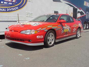

It is the factory security system.  Today, they are installing the 3rd ignition cylinder in attempts to rectify the problem.
BTW I love my car.  It is a limited edition Pace Car Monte Carlo.  I would like to get teh problem fixed but I have already spent so much money on trying to fix it with 3 differnent dealerships.
