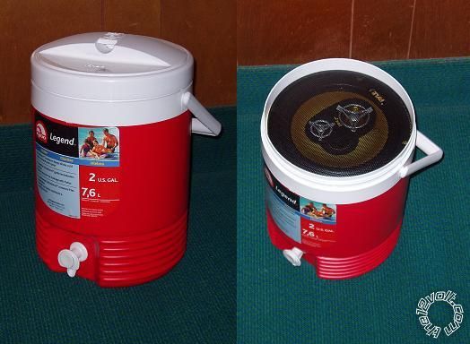

I had already built a fairly massive cooler system for the larger beach parties.  The system was composed of a Power Acoustic BMF1600/4 4ch, 150 W-rms per channel amp.  A pyle EP401 preamp (to accept my mp3 player), a Kenwood KFC-3012W sub and two Pyle PLG8.3 8" triaxials.  The amp's front two channels drove the triaxials and the rear channels were bridged for the sub.
The Triaxials are mounted in cooler jugs. Notice how the speakers are protected by the jug cap for transport and storage along with built in carry handles.
building a portable stereo -- posted image.
The jugs make great enclosuers as they are light and rigid.  The Kenwood sub was mounted in a Igloo "cube" cooler by opening the lid and gluing an MDF board inside the cooler with the appropriate cutout for the woofer.  The sub performance was fantastic.  The sealed enclosure producing a very nice base.  The triaxial speakers were adequate but I never really got the mid base to my liking.  It may be that the jugs are a little small for the 8" speakers or I just needed to fine tune adjustements, cutoffs etc a little more.
