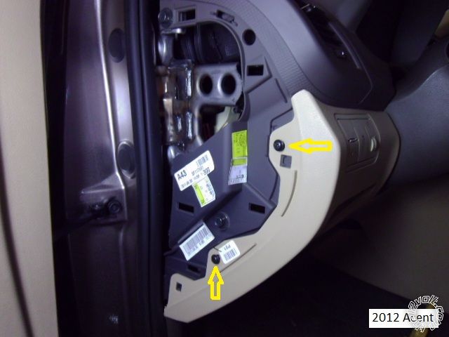

Remove the fuse box cover and driver side dash panel ( 3 snap fasteners ).   There is a removal slot in the side panel cover at 4 O'clock for use with a non-marring tool ( or screwdriver blade with the tip covered in black tape ).

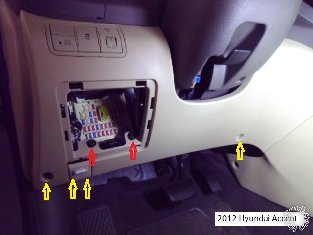

Remove the two Phillips screws marked in the photo below.  Note the square cut-outs in the lower dash panel for the next step.

Remove the four Phillips screws marked in Yellow ( two are retaining the Hood Release Lever ) and the two 10mm bolts marked in Red.  Release the retaining latches in the side dash opening and then pull the lower dash panel straight away.  There are three snap fasteners along the top edge.

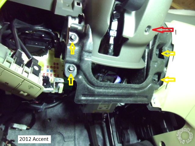

Remove the four 10mm bolts marked in Yellow and then the knee brace.  Remove the one Phillips screw marked in Red that retains the lower steering column cover.

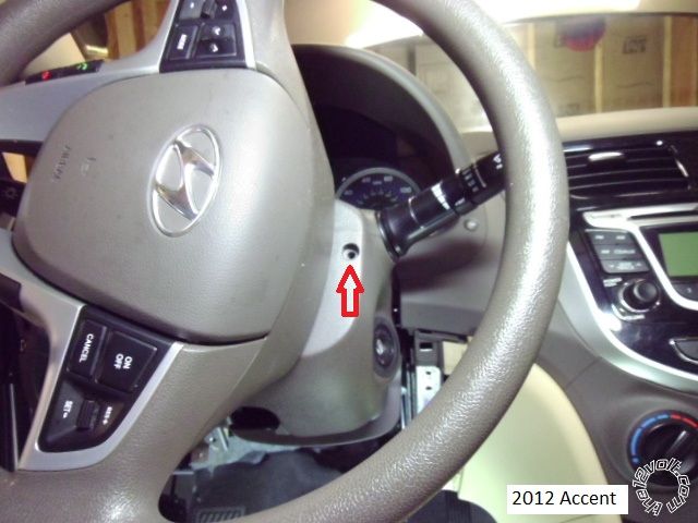

Remove the two steering column cover Phillips screws at 9 and 3 O'Clock ( 3 O'Clock shown ).  Separate the upper and lower halves of the steering column cover and
remove the lower cover.

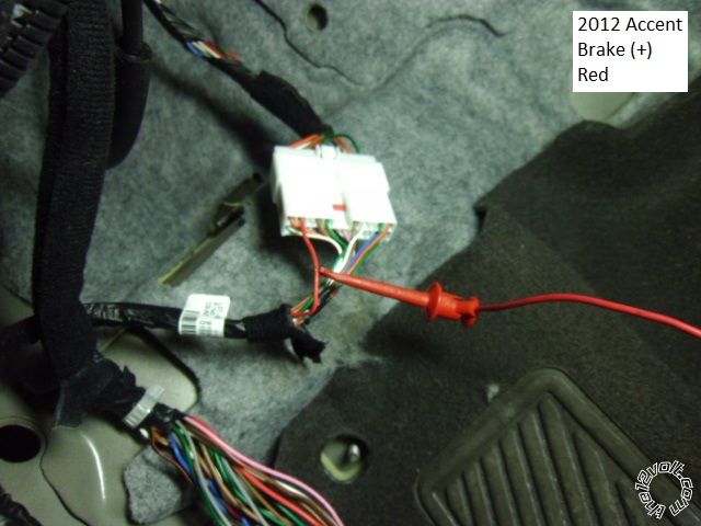

This is a picture of the (+) Brake wire found in a White 18 Pin connector above the dead pedal.

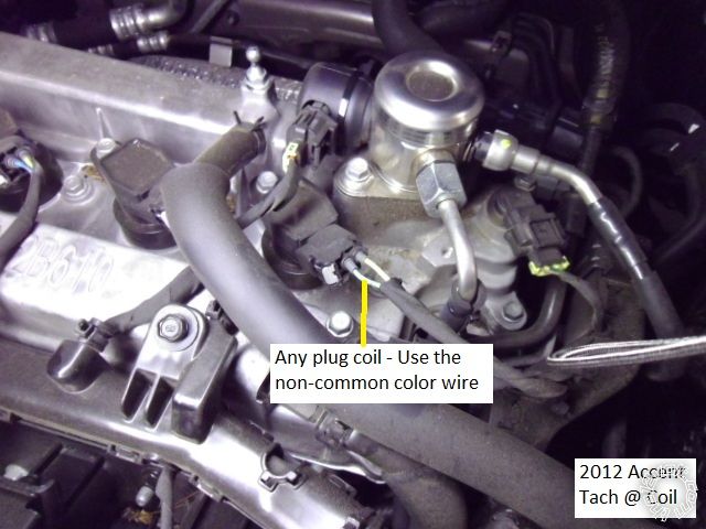

This is a picture of a Tach source at the #4 Spark Plug Coil.  Additionally, the Accent does not have "one-touch-starting" and is a candidate for Starter Kill and/or Anti-Grind.
