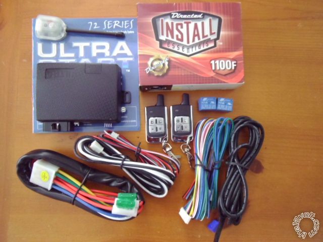

Here are the parts used for this install :
2004-2007 Ford Freestar Remote Start w/Keyless Pictorial -- posted image.
The Ultra Start U1272 has a Flex Ignition output that can support the Freestar's Accessory2 ignition wire and programming
that will allow it to use this vehicles N.C. type Factory Hood Pin.   There are other, good quality, remote start systems available
that have similar features.
The Directed 1100F bypass module has been discontinued but is a quality module that will handle the Freestar's PATS3 system.
However, two factory keys ( non-clone ) are required for bypass module programming.   The 1100F can be found at various on-line
retailers for under $20.

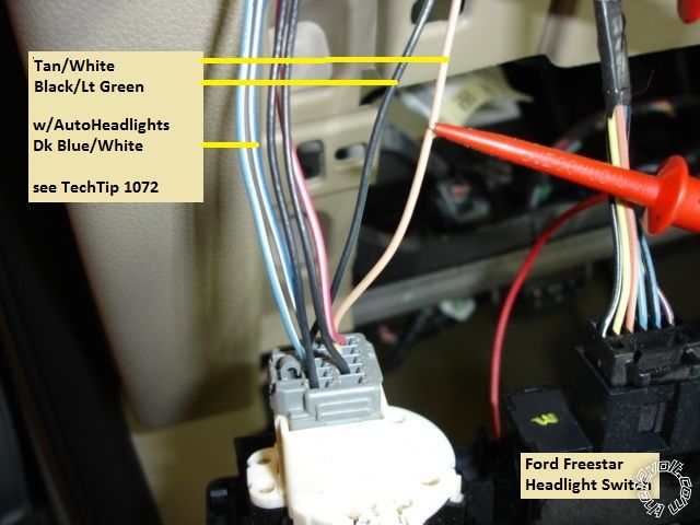

The two 10 Amp mini-relays were used to interface this vehicles unique Parking Light system requirements.  For more info,
here is a link to a ZIP file with the Directed TechTip #1072  :  https://www.the12volt.com/installbay/file.asp?ID=1076   Vehicles
without AutoHeadlights will only need one relay.

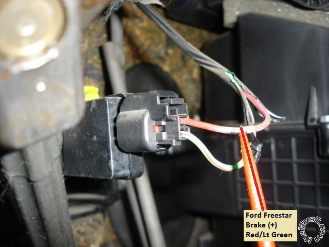

6 Pink (+) Brake Input    RED / Lt Green @ Brake Pedal Switch

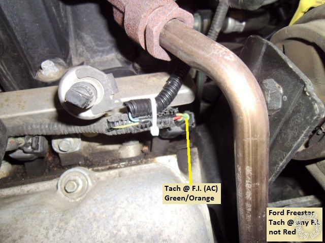

8 Blue/White (AC) Tach Input    GREEN/ Orange @ #6 F.I.  ( any F.I.; not the Red wire )

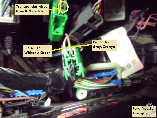

GREEN/ Red    RX         to Freestar Gray/Orange at Pin 3 of 4 Pin transponder plug
GREEN/ Red    TX         to Freestar WHITE/ Lt Green at Pin 4 of 4 Pin transponder plug

This is a picture of the Brake wire, at the brake pedal switch.

Next is the Transponder connector ( just to the right of the horn connector ).  The transponder wire colors listed in various
bypass module install guides give the wire colors on the car side of this connector.  The wire colors on the side going to the
ignition switch are different.  This connector is shown unplugged for photo and wiring.

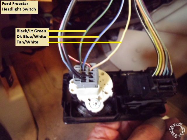

These are pictures of the Headlight switch harness.

Here is a picture of a good Tach source, the #6 Fuel Injector.
