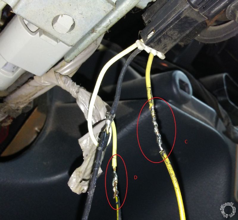

Yep, that's a mess.
The other end of the yellow wire is attached to the purple wire on the R/S harness. I can see the purple wire in the pic.
I've had to fix a couple of messes like the one you have here. I went junk-yarding, and found ignition switch pigtails from an unmolested car. I cut the connectors off with as much extra wire as I could. I spliced the new pigtails into the car using uninsulated crimp connectors, soldered them, and slid heatshrink tubing up and insulated the splice. When I reinstalled the factory split loom, the repair was undetectable, because the splices were within the loom.
I don't know what car-lines use the same ignition switch as your Cavilier, but I'm sure there are several, and for a bunch of years. Don't limit your search to same make, year and model, because there are certainly other donor models and years with the same switch and connectors.

REF A - below picture. Davep, yep, I did not realize as you did from your experience but when I took another look, I saw it as you did in the picture, thanks. Ok,I see now that there was more daylight that the other end of this yellow wire (which I believe is the starter wire) is back down in the steering column and the guy had tapped into it with a purple wire. I just happened to see it when I was looking around down in there. He had wrapped it with electrical tape and I just saw a small portion of the yellow wire by chance. So I connected the purple wire to the green (temporarily) by twisting them and electrical tape.
Uninstall or bypass remote start Avital Avistart -- posted image.
REF C & D below - I realized that this yellow wire was cut in two completely and the other wires attached to them went to the remote start relay satellite. So I just connected them back together again temporarily. I guess that is the ignition switch or something.
