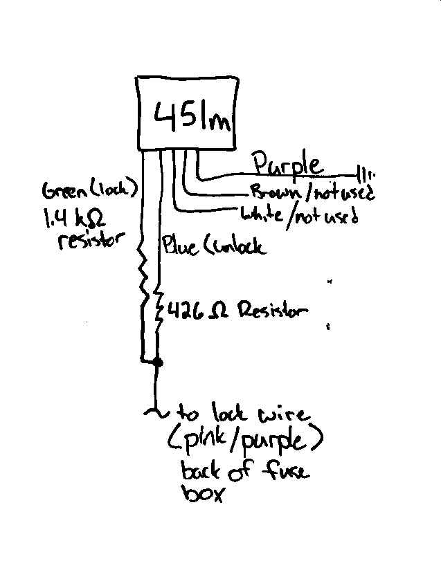

also, it came with a pack of resistors, do i need to put those anywhere..i found this picture searching through the forums..i just wanted to know if it applies to my vehicle as well....
451M in 02 Nissan Altima -- posted image.
if it does apply to me, why do the green and blue connect right before they get to back of fuse box?? also do i have to use the resistors shown here? maybe i just dont undersatnd the diagram..also this picture doesnt show the small 3wire white plug coming out the 451M..where does that go? ive read if i have a DEI alarm it just plugs into my alarm. is this true??
please dont leave out any small details that you would normally think are trivial because id really like to make this work correctly. thanks for reading..

i dont use that line...do you have a site for the parts that you have?? we should be able to get you up and running..
