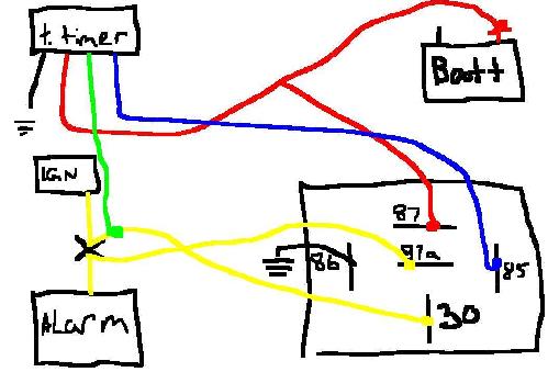

ive looked around but some q's still not answered.
hey, ive read some of your posts on how to setup a turbo timer with an alarm. im kind a noob at this but ill try to explain myself the best i can.
i got a spdt relay. clifford arrow 5 alarm and greddy turbo timer. the problem is the car wont stay on after i shut it down. but when i turn the key to on [not start it] and turn it off, the turbo timer counts down. but it wont lock the doors
turbo timer, 4 wires, black [ground], red [+12v constant], green[ign] ?, blue[acc] ive noticed with a power lead, that when green gets no power, blue has power. ie, turn car off.
ive cut the ign wire off the alarm [yellow]. connected as follows
30 -> ign [key side] + green turbo timer wire
85 -> blue acc wire of turbo timer
86 -> ground
87 -> n/a
87a-> ign [alarm side]

this is what i came up with. when i thought it out, it sounds right.Turbo Timer + alarm -- posted image.
