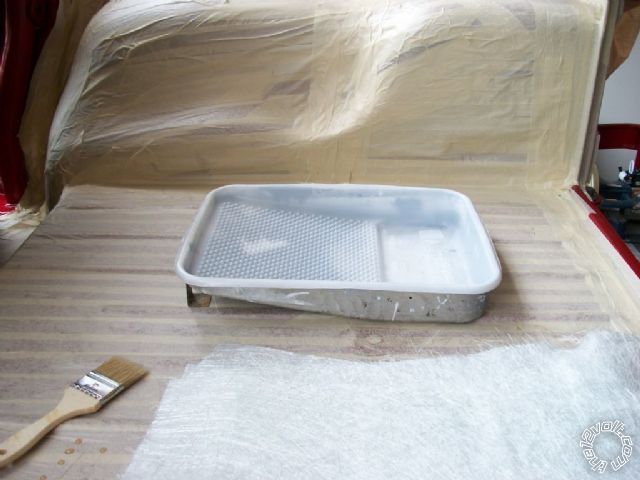

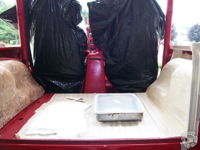

1st we start with covering everything and anything we don't want resin splashed on. IT WILL IF YOU DON'T TAKE PRECAUTIONS.
Hefty 3 ply trashbags work wonders in the vehicle and out as you can cover your work table with them by taping down the edges...make your mess...then wrap it up and toss away. Recover for the next step and so on.
1997 jeep tj, fiberglass -- posted image.
Here we taped the entire rear section of our TJ as we are going to cover this entire area with fiberglass.

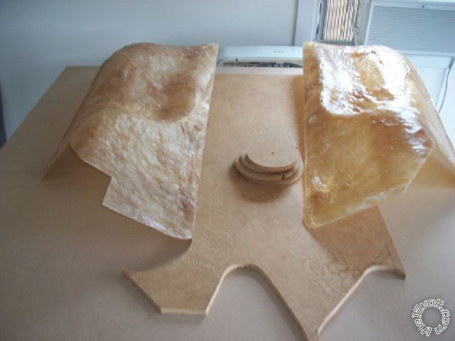

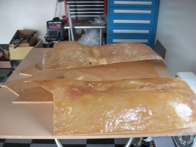

our initial layer on the driver's side completed. Below are both sides removed after curing.

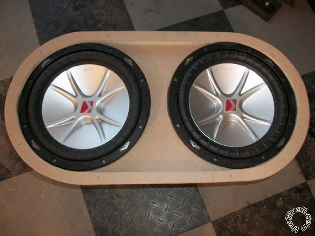

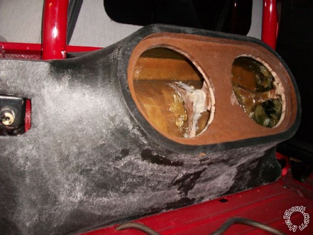

I've seen plenty of info on this site pertaining to woofer rings so i won't get into too much detail. Below we "coupled" 2 10 inch Kickers which we will do for both sides of the Jeep for a total of 4 10's.

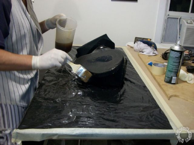

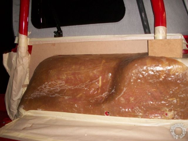

Below we have resin curing after a stretch and HOT MIX!

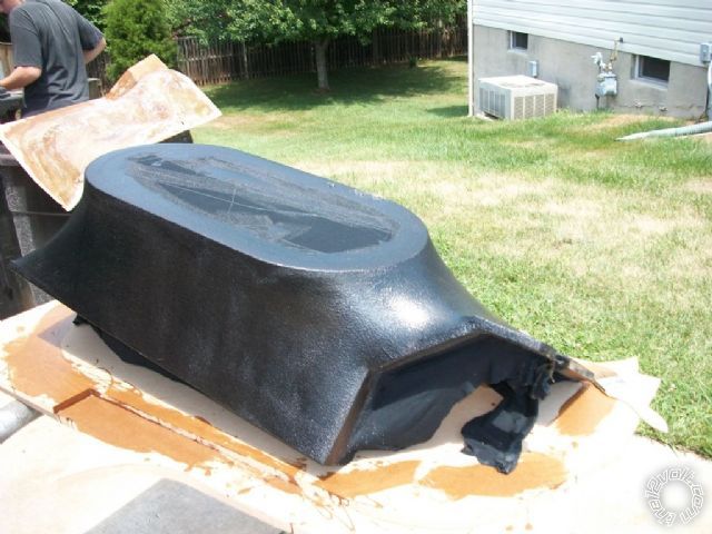

1 down 1 to go. Be careful when trimming the edges. We used very sharp razors.

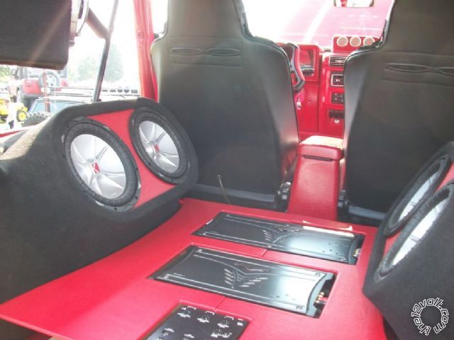

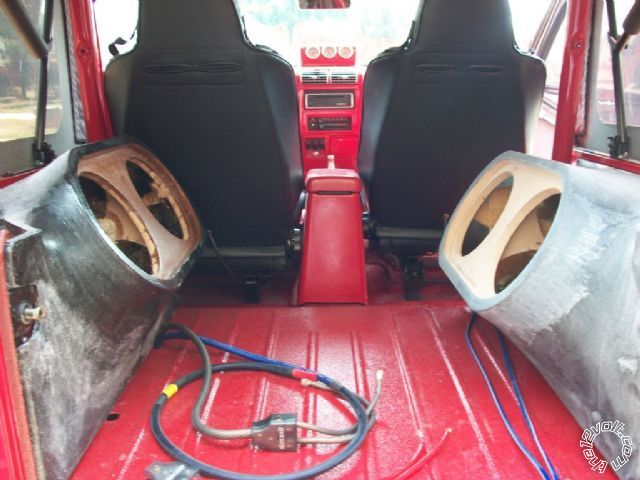

Both sides are ready for carpet. If we were to paint these, a bit more bodywork would be needed to get the enclosures perfect for painting. We were up against the clock and opted to carpet them.

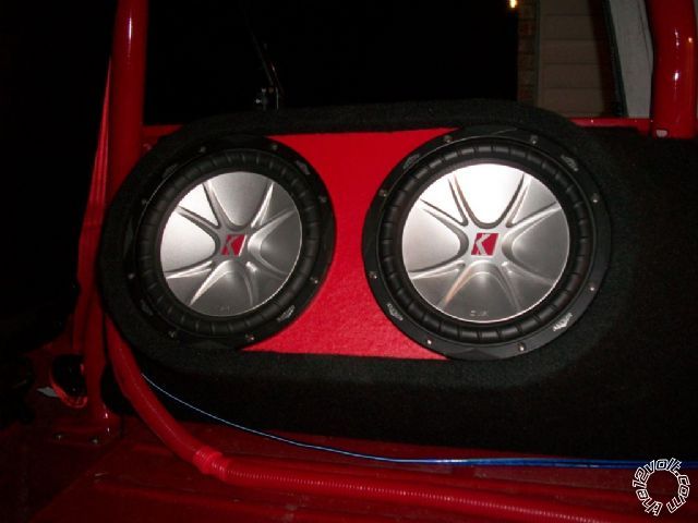

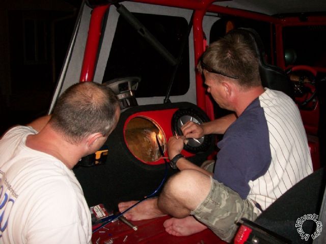

bolting the enclosures and adding the woofers.
Carpet and vinyl are a good combo when done in moderation.

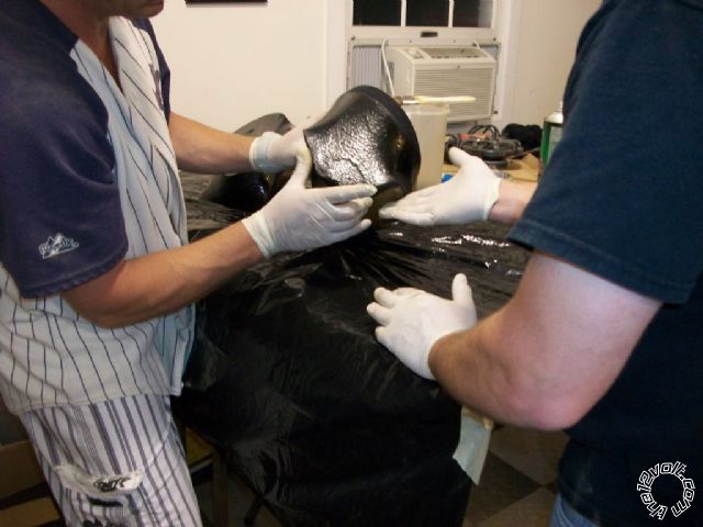

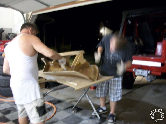

Below we see Tony B run a "Stretch and Hot Mix" over his kick panel skeletons. Just paint it on!! (gloves are a must)
Sometimes when doing complex shapes, staplers or other mechanical fastening tools just won't fit. Spray glue is your only alternative. Problem is, the resin will loosen the spray glue used to fasten the skin to the skeleton. We simply hold pressure on that area until the resin kicks off.....don't panic. it happens. just have a friend help hold the part VERY CAREFULLY if and when it does.

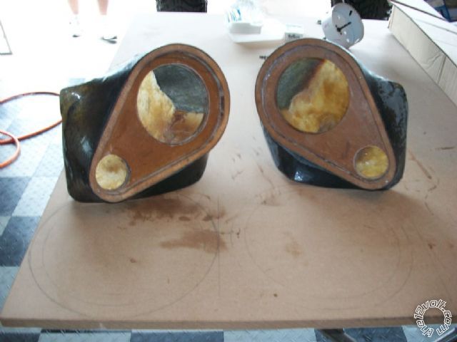

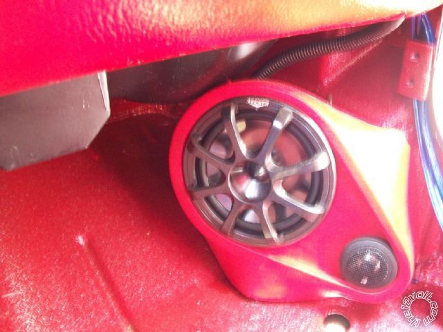

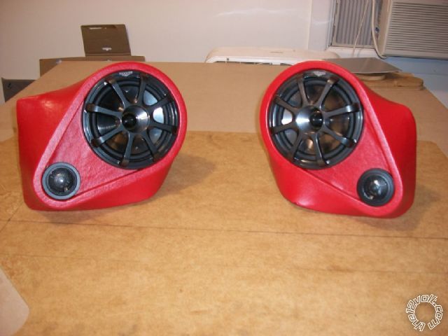

Complete set ready to cover. Below complete set covered with Red Marine vinyl from Jo Anne Fabrics and Kicker 6.5 seperates installed.

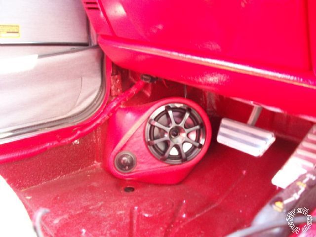

Installed on driver's side.
Installed on passenger side.
Entire TJ system completed in 84 hours start to finish!
