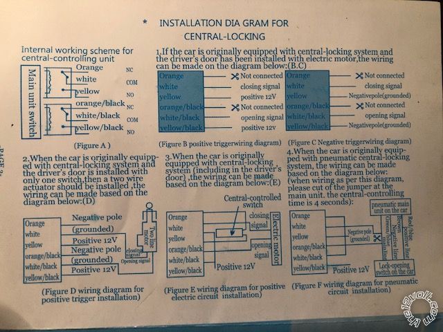

Hello all, I've been following this thread closely as I'm attempting to install the exact same keyless entry product as the original poster into my 1993 Mustang. I would like to do the install without the additional relays as previously mentioned it appears this unit has relays built into the brain.
I have located the pink/yellow and pink/green wires that I need to cut; however I'm lost as to which wires I need to connect where on the keyless entry harness. Can someone please explain which wires go where without using additional relays? Here are the diagram options/instructions that came with the unit. I believe I should be following figure E? The car does have original equipment power locks.
1993 Ford Mustang, Keyless Entry - Last Post -- posted image.
Platinum - Posts: 7,828
Posted: November 09, 2020 at 7:10 AM / IP Logged Link to Post Post Reply Quote kreg357
I'm thinking you can do it with just the aftermarket RKE unit alone. It appears to have internal relays. The upper set of wires ( Orange, Whire, Yellow ) is for Lock and the lower set ius you unlock.
The car has a positive 5 wire reverse system.
First you must local, cut and test the cars lock wires. You must determine which side of the cut wire is the motor side. Use the test shown in the post you linked. The wiring will be like this :
Combine the Yellow and Yellow/Black and connect them to +12V constant through a 15 amp fuse.
White wire to motor side of cut Lock wire.
Orange wire to switch side of cut Lock wire
White/Black wire to motor side of cut Unlock wire.
Orange/Black wire to switch side of cut Unlock wire.
That should do it.
