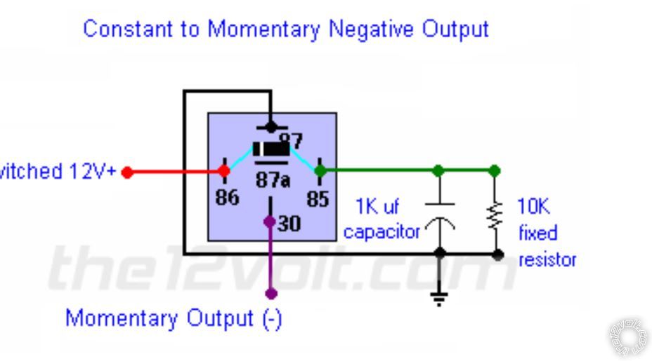

I am needing to follow this diagram, I believe. Need to have a negative pulse sent when another wire recieves 12v. The 12v will stay on for a period, so I just need a quick negative pulse, then nothing.
According to the diagram I need a 1K uf capacitor and a 10k fixed resistor.

I suppose I should list what I'm doing with this: need to send a negative pulse to a wire to unlock a door in an old car when I put the car into park. I have something providing a positive output when I put it in park which remains on until taken out of park or ignition turned off. I have the negative wire that I would use to send the negative pulse to unlock the car. So I just need to build this resistor, relay, capacitor setup to handle the work.

Try searching for a 1,000 microfarad capacitor, not a "1K uf resistor". You also need a 10,000 ohm resistor for the relay diagram you referenced.

I am wantint to send a momentary negative output to a door unlock switch. I want it to be triggered by putting the car in park. I have a positive wire ouput when this happens, although it is constantly positive output until I turn the engine off.
This diagram from the 12Volt diagrams looks like what I need to do:
Constant To Momentary Output Relay Diagram - Last Post -- posted image.
With only a curosory glance to get the capacitor and resister ordered I am now studying it a bit more to make it happen. But now I'm not so sure about this.
None of the wires are notated as the source positive wire in the diagram. I was assuming I'd put the wire that puts out the + when in park at 87. But looking at this diagram that goes to a gnd. I suppose that t86 being a switched 12v could be it. Given that the wire is not 12v 100% of the time...ie. it is hot when the care is in Park AND the ign on. So, just to verify, does that sound right?
The other thing, I'm no electronics builder. I had thought originally of putting the capacitor and resistor in series between 87 and 85. But I'm not thinking that is right. Do I need to make it physically as drawn? ie. 85 go a junction which also has GND and the capacitory, and a lead off that to the resister. Other end of resister goes to a wire to a junction with the capacitor, then a wire from there to 85.

Terminal 86 is connected to the 12V+ source. Terminal 87 is connected to ground as is the negative side of the capacitor and one side of the resistor. Do not wire the capacitor and resistor in series with terminal 87. Yes, you need to wire it as shown in my diagram. Terminal 30 will provide a momentary negative pulse when 12V+ is applied to terminal 86.

Thanks. Just finished up, and it works fine.
