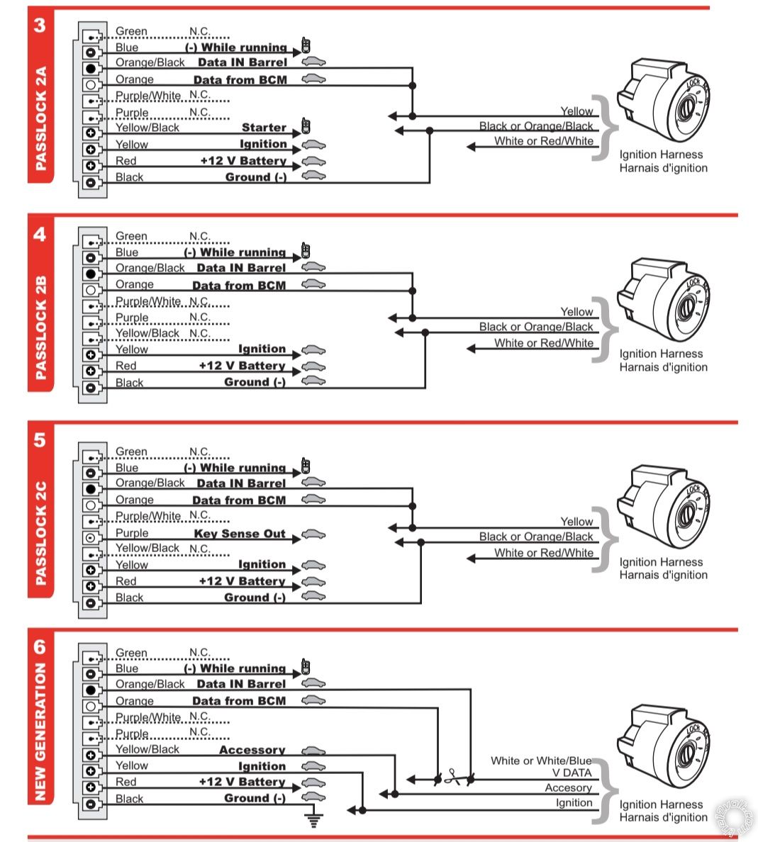

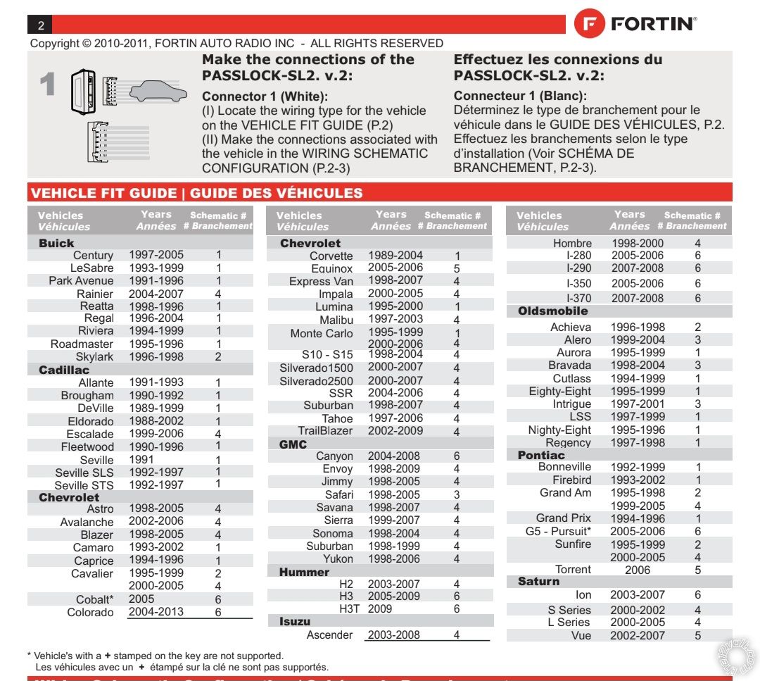

The security light comes on immediately after it dies. The passlock 2 blinks 5 times when programmed. I spoke with customer support and they didn't seem concerned about the 5 flashes. I saw in a video that it was supposed to flash 3x. According to the schematics I'm supposed to use diagram 4 (Passlock2B). It shoes that Orange/Black and Orange both connect to the yellow wire @ the ignition and the black ground wire goes to the Black/Orange @ the ignition. Assuming these are the wires that plug into the key cylinder.

Yes, Schematic 4 is correct. Those 3 Passlock2 wires do come from the ignition cylinder.
The Yellow wire should be 5V and then drop down a bit (depending on the cylinders internal resistor value) when the key is turned to Start.
You could try re-programming the module after verifying the Passlock2 wires.
