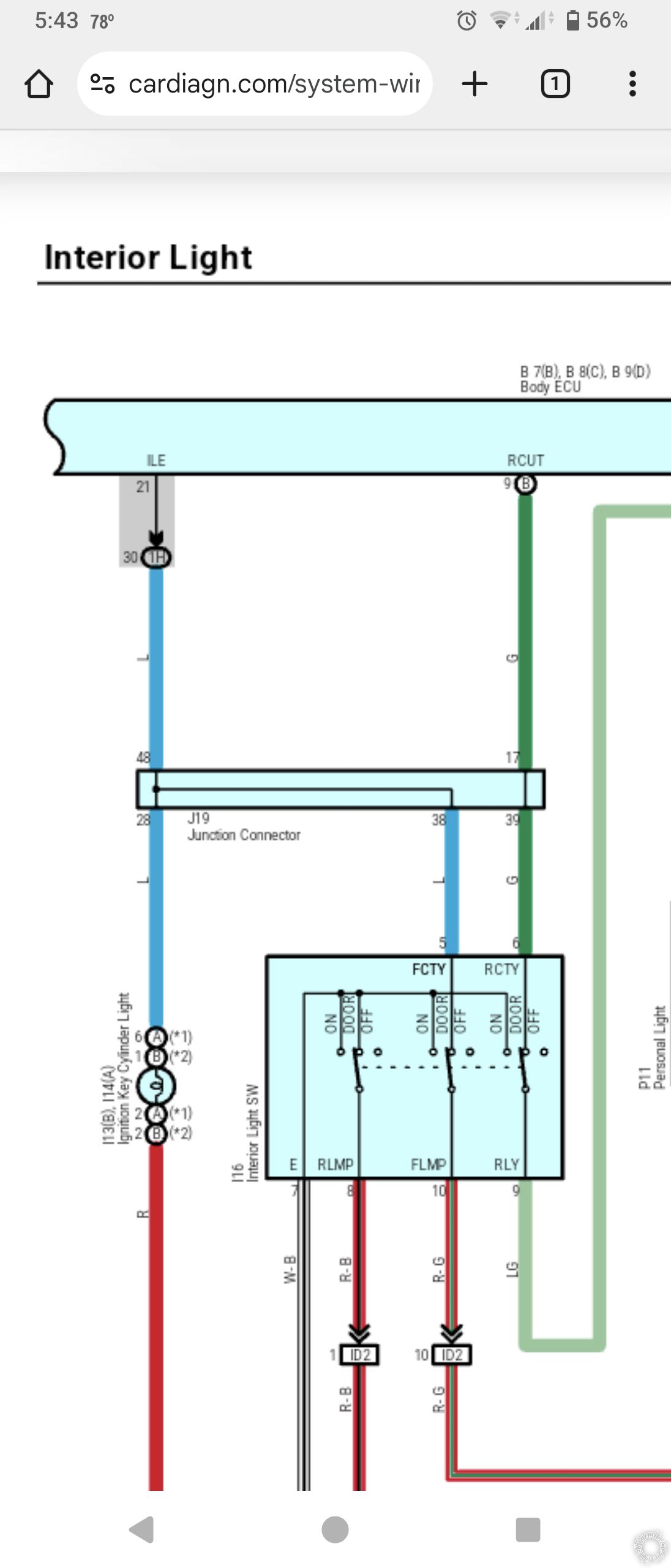

This is the switch on the dash. I see it listed as negative trigger. A diode shouldn't be necessary: https://jdmfsm.info/Auto/--General--/Autoelectric%20schemas/Alarm%20cables/index2be3.html?MakeID=2&ModelID=18040
2004 Toyota Sienna, All Doors Open Wiring? - Last Post -- posted image.
Since the white/black ground wire is only used in the on position, we can deduce the blue wire is a negative door trigger.

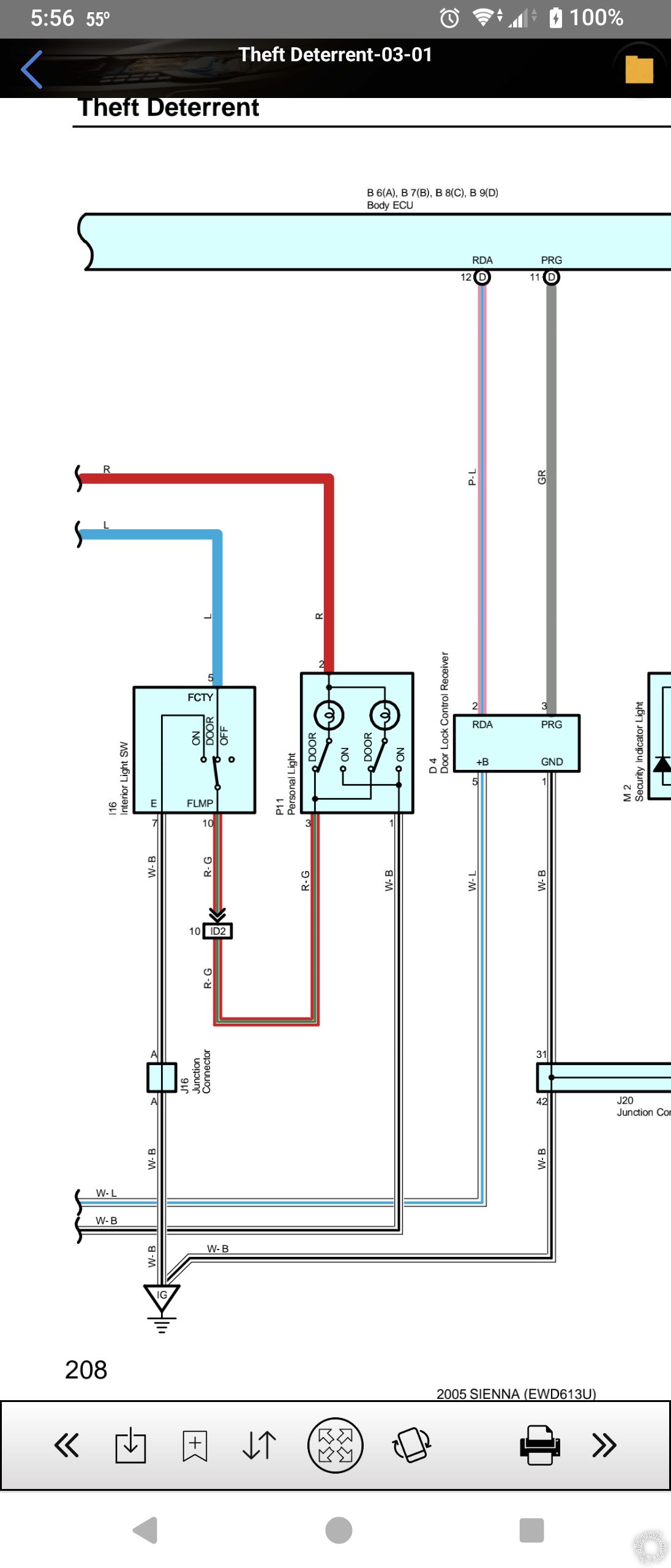

Even if it's not blue, this wire should be located in pin 5 of the connector at the interior light switch.
Touch the positive meter lead to a constant 12 volts and the negative lead to the suspected wire. Your meter should show 0 with the doors closed and 12 volts when open.
The diagram shows this wire has continuity with the ignition key cylinder light so you might check there, too.
If you locate this wire test if it shows ground with the back door open. If not you may need to diode isolate and connect to pin 6 as well.
