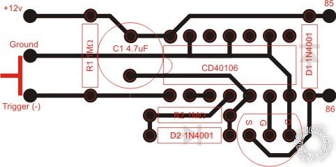

How's this?
2 3 seconds to trigger relay - Page 2 -- posted image.

cmorales wrote:
How's this?
I'm impressed- 2 3 seconds to trigger relay - Page 2 -- posted image.
The drain and source on the transistor is reversed (that is, your outline and pin definitions are correct, but the wiring is swapped- pin 1 is Drain, pin 2 is Gate, pin 3 is Source), but if you just plug it in 180 degrees from the outline shown, it should be fine (or use a 2N7000, which has the opposite pins )-
Also, be sure to observe polarity on the diodes and caps, since they're not marked on there.
p.s.  Check mouser.com for the parts if you have any problems finding them at a reasonable price.
