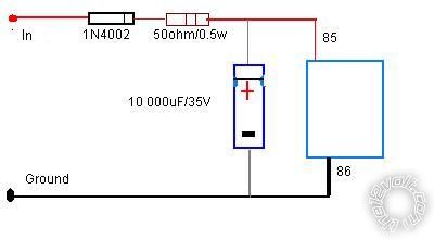

I been searching for a way to trigger a relay ONLY if I press a switch longer than 2 or 3 seconds and only thing I could find is this old tread.
Will this work or is there a better simpler way?
Thanks.

I´m trying to prevent opening the trunk by mistake, the switch is too accesible...
Can I put two 4700uF capacitors in series to get 9400uF?
2 3 seconds to trigger relay -- posted image.

Well. It didn't worked. Could it be because I used two 4700 uM capacitors in parallel?
Platinum - Posts: 13,725
Posted: January 14, 2011 at 10:05 AM / IP Logged
The only thing that would keep this from working is the direction of or the placement of the diode.  The drawing has the diode in the positive leg.  If the diode is in the negative leg, you must turn it around.

connected everything as the diagram. only thing different is the capacitor, I used two 4700uF/25v capacitors in parallel. The thing was that the relay activated instantly and not after 2 secs.

What if put the resistor between the capacitor and the relay?
The relay is a 12v/30A automotive relay. Does that makes a difference?

The resistor has to be exactly where it is in the diagram.  Are you sure you have a 50 ohm resistor, and 4700 mic capacitors.
