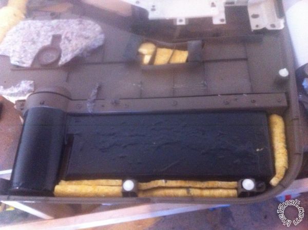

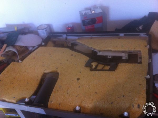

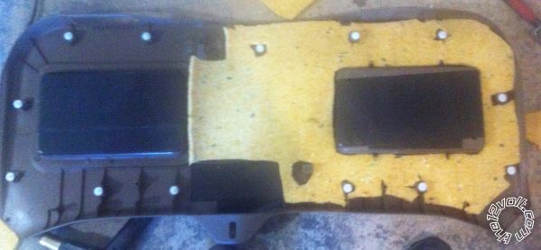

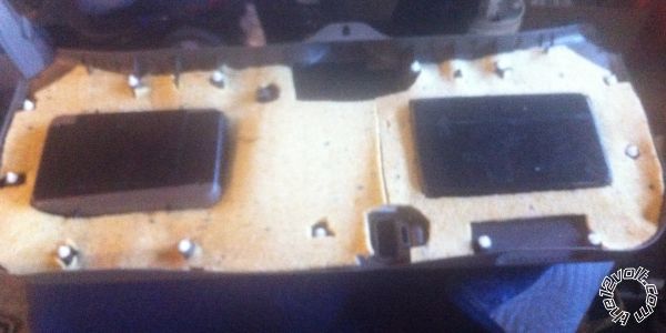

Did the soundproofing on the door and tailgate panels.
laid the rubber and open cell foam. I was going to use Great Stuff in the large gaps, but its messy and expands to much which may cause the door panels to warp.

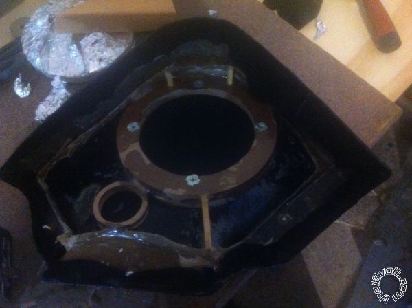

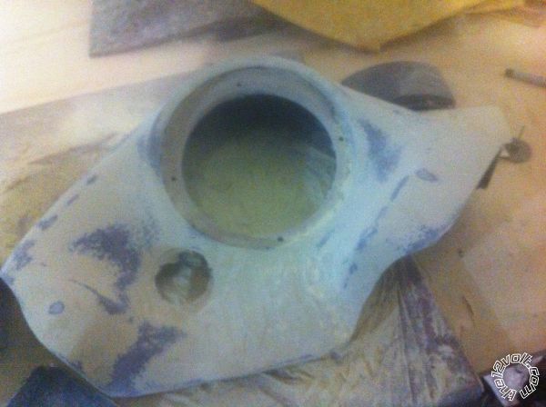

laid 5 layers to inside of the pods. Didn't put any on the outside cause i didn't want to bulk up the nice curves.
2007 Nissan Pathfinder, Fiberglass Projects - Page 5 -- posted image.

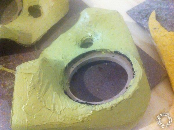

put on filler and Cant get good curves with machine sanders so i hand sanded for 3 hours and still not done.

The yellow foam is just carpet lining from your local Carpet Store. Its the same open cell foam that the car audio company's push on us, just not as pretty lol. i think i pay $100 for a 20'x10'x3/4" roll, got it last year. I glued down MLV (got from Amazon) to the panels fist and then put the cell foam on. Cheaper then deadner and way better improvement.

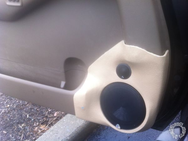

OK so i finished the door pod!!!! not liking them at all!!!!
1) color doesn't flow with the doors
   need to add a few flat panel designs with more same color.
2) dam pod edges are way too thick
   sand the hell out of them to 1/8 thick instead of the 3/8 (got a little layer happy when i got the new FG rollers in LOL)
3) there is a lot of where and tear in the doors so I'm going to cover the pod in beige vinyl.
Guys let me know what else you see wrong!!!! open to comments and help

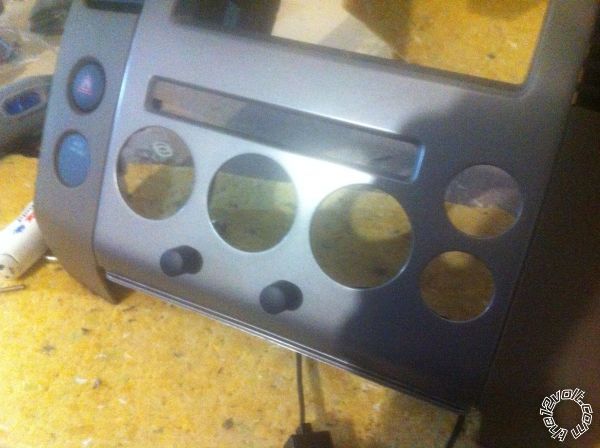

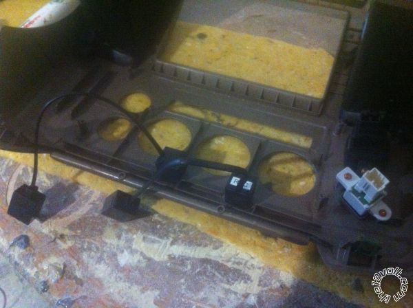

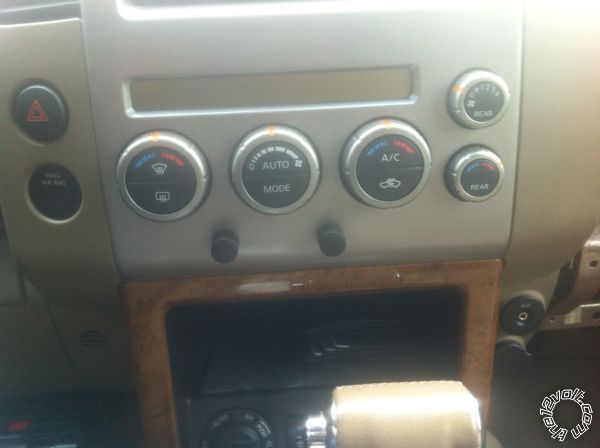

Installed the JL amp volume controls and the pioneer rear-view camera controller in the dash. The local shop that install the Avic-Z130bt did a very bad job on the install. Had to redo most of it. Even worst they put the GPS antenna behind the radio under the dash. wth NO WONDER why my GPS was always giving problems. Going to mount it on the center dash.

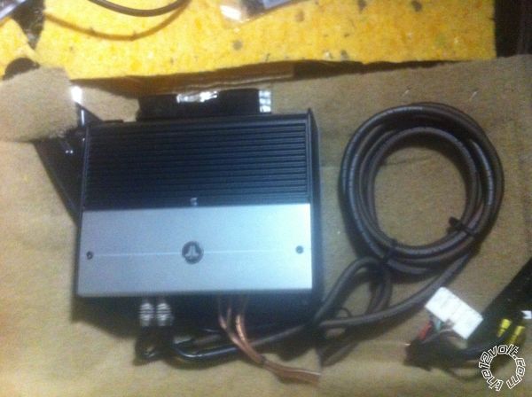

Wired the RCA's and front a-pillar speaker wires (still haven't ran any of my power/ground wires) to the JL XD400/4 under the driver seat
Cut the volume controller wire and re-crimped the RJ-3 jack (just so you guys know the JL volume controller wire is just a simple 4wire pots line crossed over)

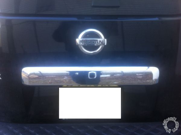

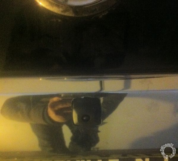

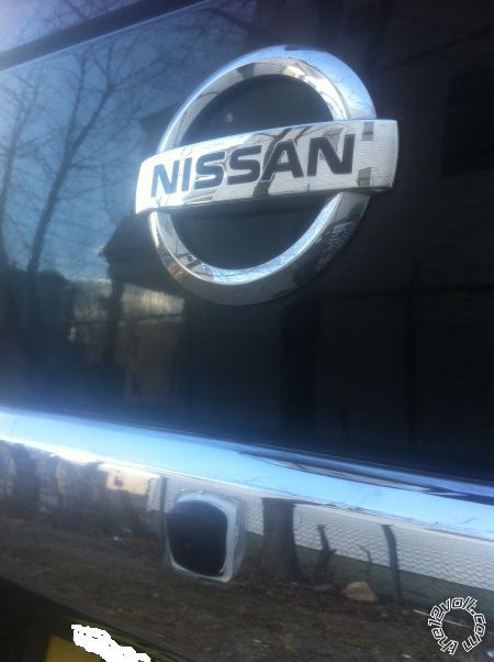

Ok i already had the Tail panels removed for deadening..... SOOOO i installed a Pioneer Backup Camera ND-BC20PA into the rear chrome tail cover. I wanted it to look like the factory install. All i need to do now is make a square cover and stick it on to cover the caulking around the camera.

did you have to cut a hole for that rear view camera? or did you do that so it would sit more flush?
