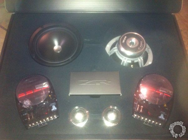

OK so I wasn't very happy with the JL Audio C3-650's..... So purchased the JL ZR650 front the fronts :)

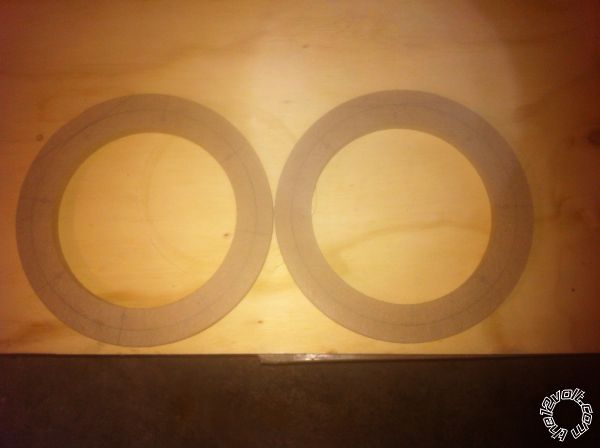

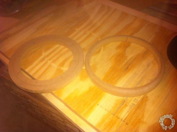

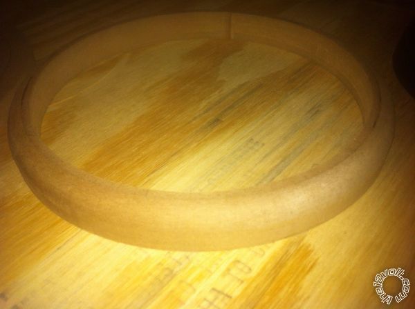

New rings for the ZR's, I round the top to get a better shape on the FGing. Still need to drill the 8 holes and add T-nuts to the rings

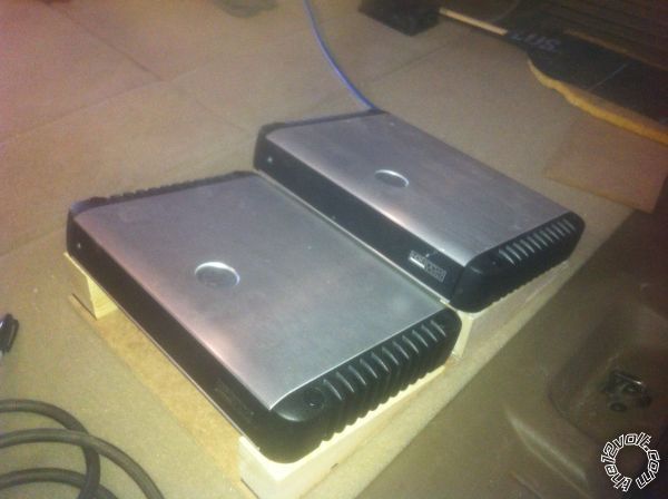

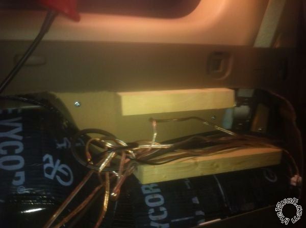

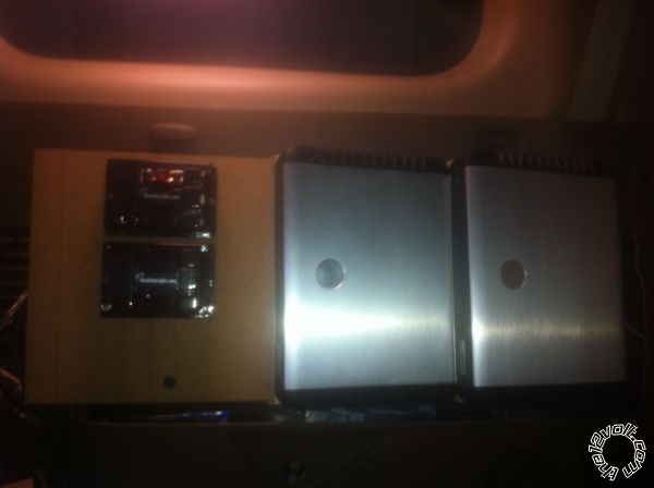

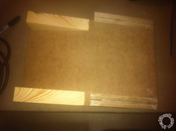

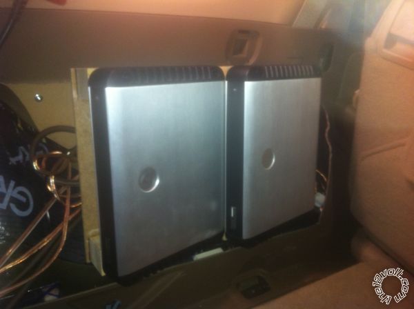

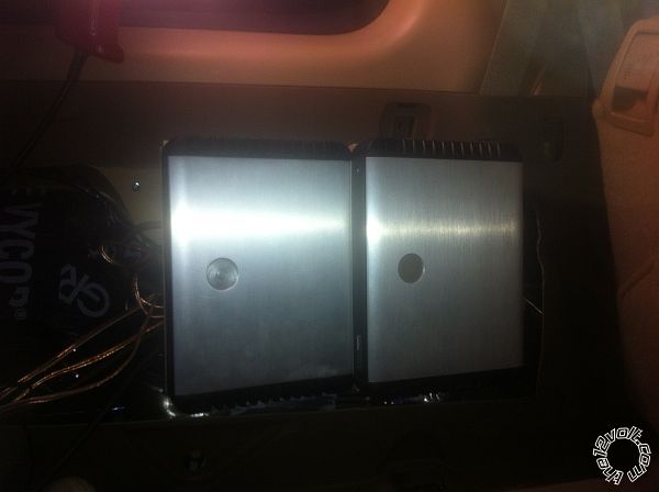

Also started on the amp rack above the rear driver side tire well. With the limited space I changed the amps from the Slash 500/1 and 300/4 to JL Audio HD1200/1 and HD600/4

i hope your new components sound as good as you think they will, ive never been a fan of JL speakers, although ive never heard a set of ZR's, im sure they sound pretty nice when properly installed. they come in a nice box, my diamond D9's came in a wooden chest and the crossovers are probably 3X the size of those JL's. honestly, any speakers that come in a special box should sound awesome, even though i think you used the flash on your phone to make them look nice and sparkly 2007 Nissan Pathfinder, Fiberglass Projects - Page 6 -- posted image.
