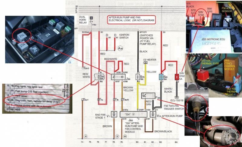

I was trying to create a circuit for a after run pump so that when the vehicles Ignition switch is off and the temperature sensor is above a certain temp, the cooling fan kicks on as well as the pump. An Audi 5000 has this system, I think using a similar system would be my best bet.
(http://forums.quattroworld.com/s4s6/msgs/21503.phtml).

So i have looked at the diagrams and they are set up quite different and I am unsure what should be the input into the timer. I would presume that
terminal 15 is the ignition switch
terminal 31 ground
terminal 30 use the switch but instead of using + flip it to -
terminal 87A would ground the fan relay, afterrun pump
Also I would not use terminal 87
I would like to run a similar setup to the orginial,

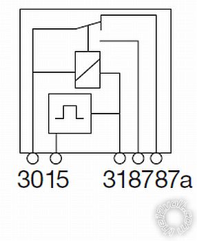

The hella relay is set up in this configuration
After Run Pump Relay Needed -- posted image.
The original fan relay uses a - input trigger for relay.

If the Hella is a direct plugin for the fan relay (with added small terminal wiring) then I'd be tempted. My only concern would be if it draws current with IGN off - ie, from what I've seen such relays tend to use 555 timers and they have their 10mA standby draw. That's no problem for their fuel pump control relays (missing pulse aka tachometric 555 circuits) because they are powered via IGN +12V, but not seeing in the above relay schematic what timing circuit is used nor how it is powered after IGN off...

I asked hella if the timer input can be reversed with a negative signal and have a positive on the other side or if they had an option on something else they make. It probably is a no but I was curious.
I like the 528T and i am not going against what you guys are saying about it, but in terms of longevity and overall reliability wouldn't a hella style relay perform overall better and be simpler then the 528T.    What makes the 528T a better choice? This is purely for my curiosity.
