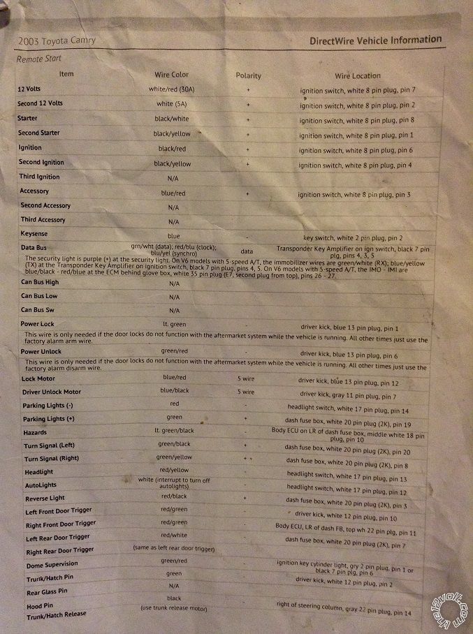

5704 Python dball2, 2003 Camry -- posted image.
my car does have two starter wires I didn't post in form of a question. Sorry I'm not trying to waist my time I mean your time. But I was making sure I didn't have to cut wires. So Relays and my two starter wires?? If You could just tell me which wires on this pic I'm about to post I should connect??? And I just want to be sure that I couldn't have done anything with the wiring to cause it to overheat.?? or the check engine light to come on?.
5704 Python dball2, 2003 Camry -- posted image.5704 Python dball2, 2003 Camry -- posted image.

for the h3 harness the big one it says violet starter out put car side,   Green starter output key side but tedmond just mentioned the violet wire not the green one do I not worry about the green one and why???
William W Rabon
smokeman1
Platinum - Posts: 1,589
Joined: September 14, 2009
Posted: March 19, 2015 at 12:06 PM / IP Logged Link to Post Post Reply Quote smokeman1
You don't need to use the green on IF you don't cut the starter wire. Cutting the starter wire provides a "STARTER KILL" to the vehicle. Cutting the starter wire, violet to car side of cut wire, Green to Key side of cut wire.
freqsounds
Copper - Posts: 289
Joined: October 17, 2008
Posted: March 19, 2015 at 12:07 PM / IP Logged Link to Post Post Reply Quote freqsounds
The setup with the violet and green wires is for vehicles that do not have immobilizers or where the vehicle's immobilizer is permanently disabled. It causes the remote starter to control whether your car receives signal to engage the starter.
In your setup, the DBALL bypasses your immobilizer only during remote start. Your car's immobilizer is still fully intact and effectively does exactly what this green wire does. So this wire is not needed. Your car will do the starter cut-out from factory.
The violet wire is an output wire. When the remote start system engages, it sends +12V to the violet when it engages the starter.
The green wire is an input wire. It simply watches for +12V from turning the physical key. If the system is armed, it doesn't send the +12V over the violet wire. If disarmed, it will.
The chip in your key is what tells your car whether to turn the starter. Without the chip, your car will disable the starter. This is why it's not needed. The DBALL "simulates" having a key with the correct chip.

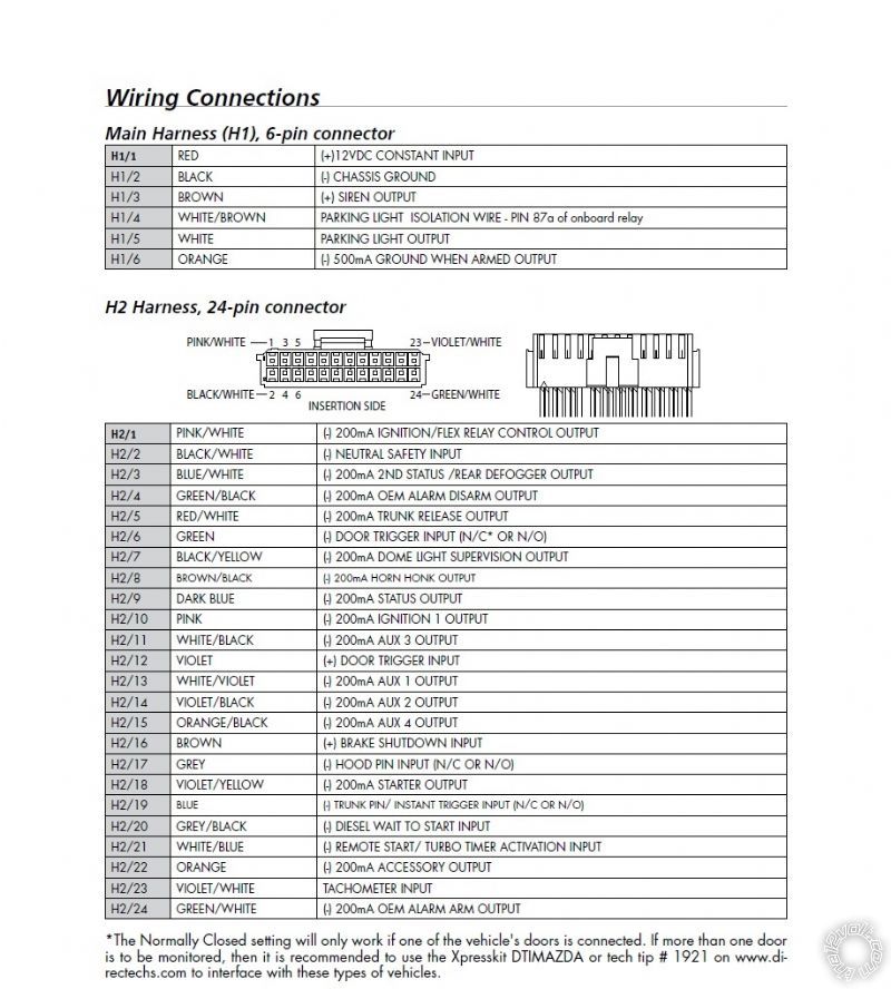

Posted: March 19, 2015 at 2:57 PM / IP Logged Link to Post Post Reply Quote w.w.rabon
The lock output do I use the 3 pin harness green wire or the violet 24 pin # 12 wire I put a chart of my vehicle wiring on page 12
William W Rabon
w.w.rabon
Member - Posts: 17
Joined: March 19, 2015
Posted: March 19, 2015 at 3:00 PM / IP Logged Link to Post Post Reply Quote w.w.rabon
sorry the diagram is on page 11 and where do I put the lock output wire on my car?
