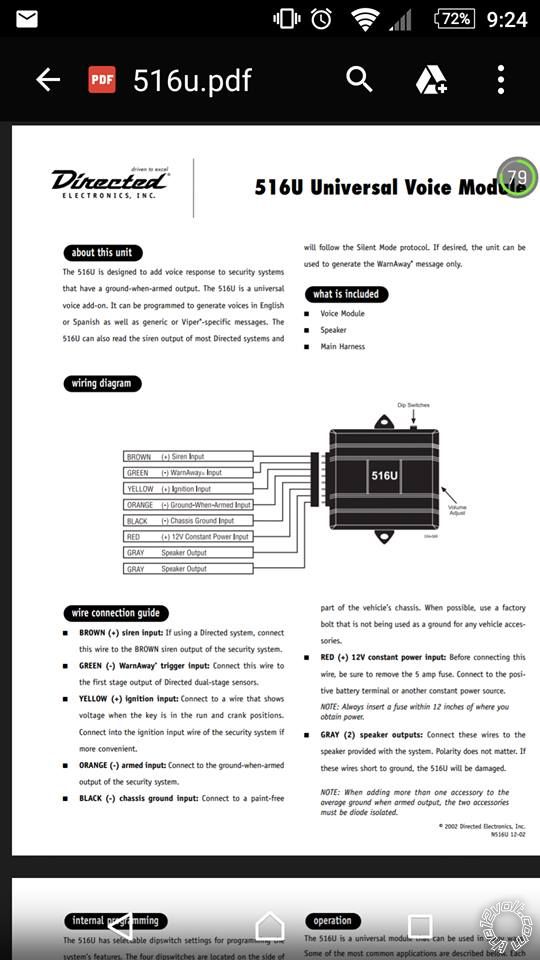

Posted: March 06, 2016 at 11:28 AM / IP Logged Link to Post Post Reply Quote kulblue
The Manual for DEI 516U
How to Create a Ground While Armed? - Page 2 -- posted image.
