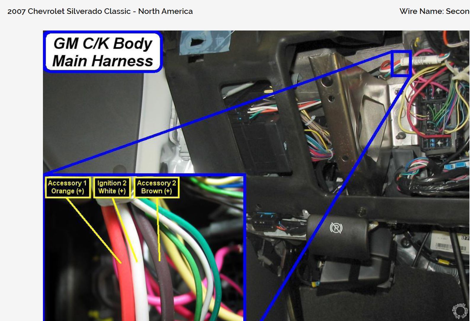

Does your trucks under dash wiring look like this vehicle?
https://www.the12volt.com/installbay/forum_posts.asp?tid=133000
Did you power the trucks White IGN2 wire with the U1280's thick White programmable ignition output wire?

Thanks for the reply. No. This is not what mine looks like. There are no white wires in the harness at all. Nothing large or small.
This morning I experimented with cutting the tach wire from the bypass module and wired the tach wire from the remote start. It starts and runs now, but throws ABS and service 4wd warnings.
This pickup chassis was made in November of '06, but even though it looks classic, it doesn't have the same wiring as what is listed for a classic. I can only fine ONE ignition wire. I am almost certain that this is where my error is, but it just doesnt' seem to be there. I can post a pic if that would help.

I am so confused.. it should be pretty obvious if you have a classic / new body style.. as the wiring is completely different.. the new body style, uses thin wires and has a pk3 connector. the old body style uses heavy gauge wires, and you must hook up the 2nd white ignition wire. (my experience it's may not be with the main harness bundle, but usually next to the brown radio accessory wire..
Can you attach a pic of the cluster / main harness?2007 Chevrolet Silverado 1500 Classic, Remote Start Trouble -- posted image.
