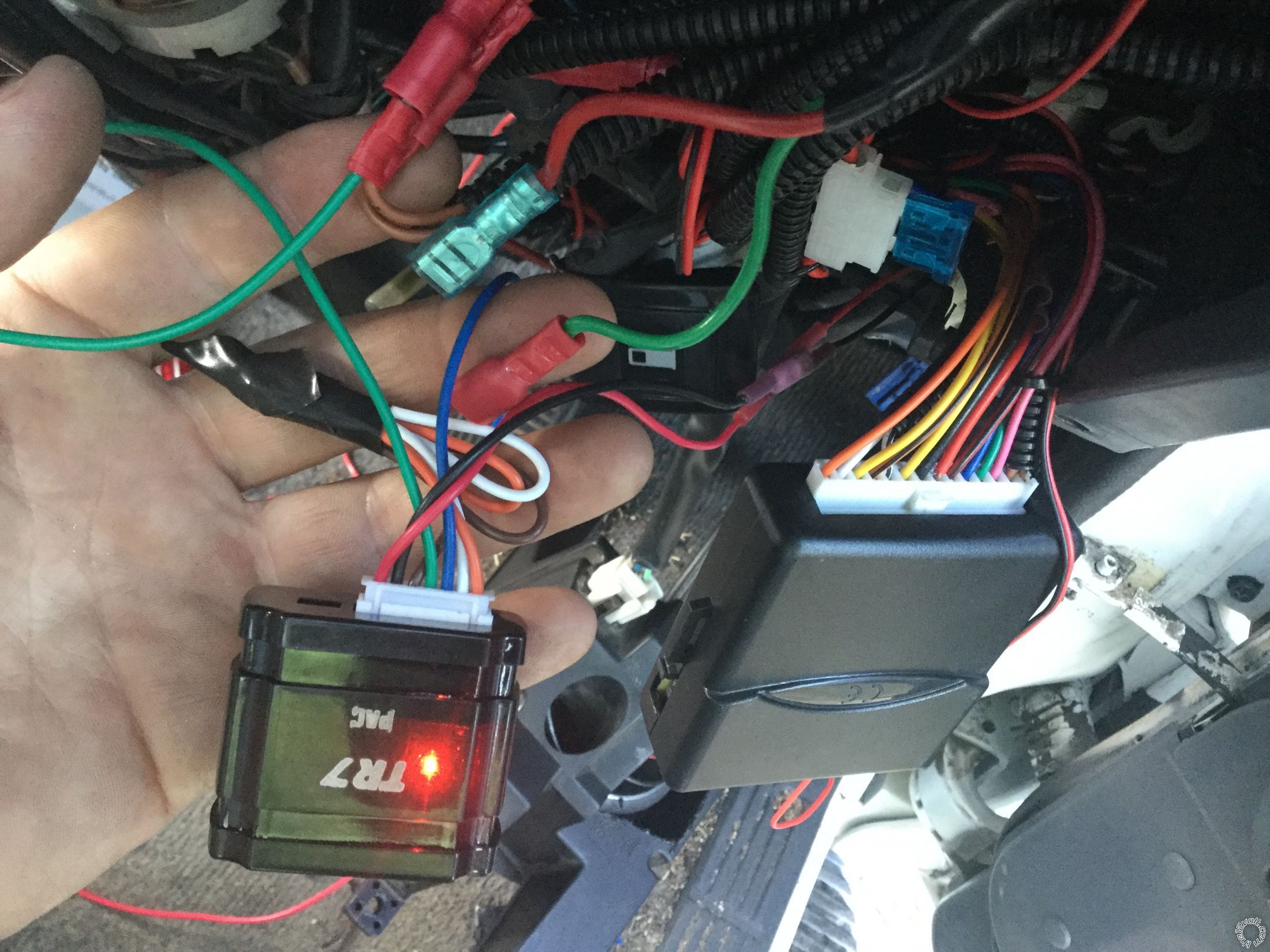

Posted: September 26, 2020 at 7:38 AM / IP Logged Link to Post Post Reply Quote henno
Has anybody got experience setting up one of these TR7s? There seems lots of advice on how to use them to watch Alpine DVD players while you’re driving.
I want to set up mine to latch the output on to turn on my stereo head unit when it gets 2 pulses from my remote entry receiver unit that go to my flashers/blinkers on unlocking the doors. Then unlatch to turn off head unit (1pulse from blinkers) when I lock doors.
I can set it up to go into Feature 13 by earthing the brown wire 13 times and getting that many flashes back but,,,,. The next step where I have to set it up so 2 pulses = on and 1 pulse = off is doing my bloody head in!
I tried feature 3 as a standard one pulse latch but none of the outputs from the keyless radio would get it on and off how I wanted every time. Feature 13 using the hazard/blinker pulses is good because there is a known difference between the on and off commands so I can’t get it out of sync if I double push a remote button.
henno
Member - Posts: 9
Joined: July 27, 2020
Posted: October 03, 2020 at 7:22 AM / IP Logged Link to Post Post Reply Quote henno
So my mad scheme to have my head unit turn on or off using my keyless remote works with a glitch.
I have the PAC TR7 set up to be triggered via its green pos input wire connected to the brown outputs that supply one flash to turn signals for lock and two for unlock.
Problem became apparent when I took it for a drive and put my turn signal on and it turns off my stereo! Hilarious really.
Is there any way the brown outputs from the keyless entry radio (still connected to input wire of TR7) can still pass their pulses to the lights but the inputs on that same wire coming from my hazard button or turn signal stalk don’t get their pulses back to the TR7?
Would it be as simple as a diode in-line? If so what value or is their a preferred auto component for this task?
