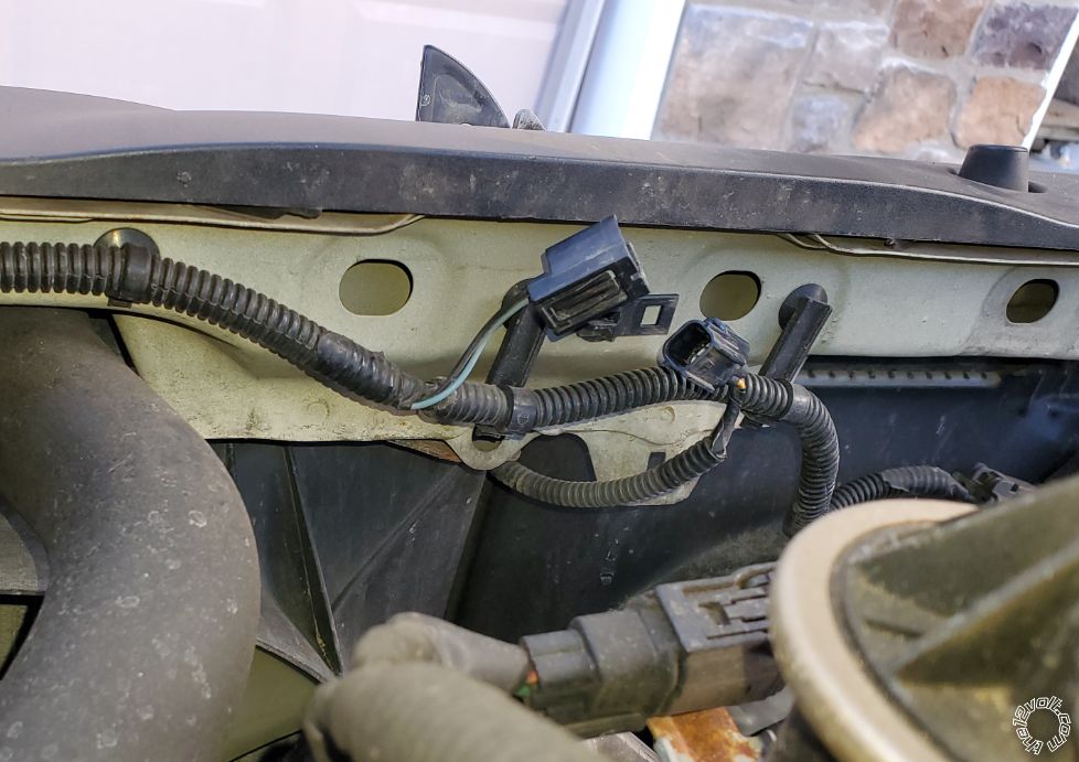

Ive scoured the threads and resources and have seen the guidance for the factory hood pin wire:
(Hood Pin: lt. blue - pin switch or fuse box, mid 21 pin plug). another source said it was specifically pin 13.
some other sources on the web have said it was
2) in the blue connector slide lock attached to the bottom of the fuse box next to the yellow SRS connector
3) in a connector gange attached to the body just below the fuse block
4) somebody else said they pulled it from the wire as it rose up off the floor in the harness loom
The car has the factory hood latch with the signal wire, so it's got the lead, as far as I can tell.
I can't find a 21-pin plug anywhere. Have found a couple 20-pin plugs in&around the cabin fuse box.

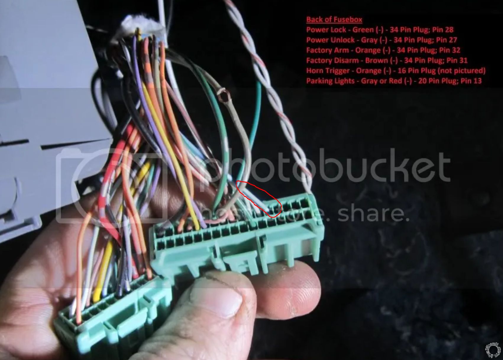

In this site's "2007 Honda Civic Remote Start Pictorial" thread, there is a pic of a 20pin block from the back of the cabin fuse block, with a lt. blue wire (circled in RED), in what looks like pin 13
Factory Hood Pin Wire, 2008 Honda Civic EX AT -- posted image.
Any advice on where I should look would be hugely appreciated

Im not sure I understand what you are saying by "only 2 connections at the steering column". Are you saying the parking lights & lights off connections are what is needed to install the remote start successfully, and the other 2 connections are either not needed to get the RS kit up and running, or provided by the HA2 harness natively?
for clarity, my original plan was going to pull the parking lights, lights off & horn off the steering column wires, and the factory hood sensor off the wire/connector as discussed above (but couldnt find it).

As for the Hood Pin, it's strange that the iDatastart doesn't pick that signal up for you. Did you do the alarm test to see if the Factory Alarm triggers when the hood is released? This test will prove that you have a factory Hood Pin and it still works. If it doesn't work, my next step would be to examine the hood latch assy to check for the connector and wires there. One of them should be the Light Blue wire you are searching for. Here is the only info on the Hood Pin wire I can find :
Hood Pin        Light Blue (-)     @ dash fuse box, Blue 21 pin plug, pin 13
The two fuse box connectors you posted a picture of above are Green and not the correct one.

I thought I would start with the actual factory hood switch
With the key turned to ON position, Im getting voltage on the factory harness (lt. blue and black wires connector).
however, regardless if the latch is open or closed (pushed it closed/locked with a tool), continuity checking shows the actual latch switch is reading as an open circuit in either case.
so maybe it's a bad latch switch with an always open circuit, thus always showings as a closed hood?
