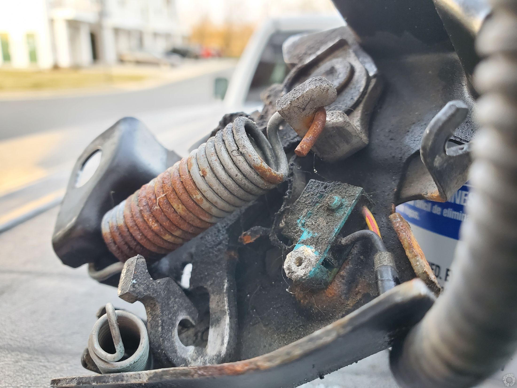

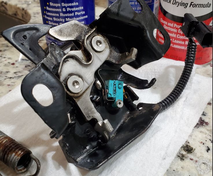

because I can get a little OCD, I went outside last night and pulled the latch. it was, like most hood latches, totally grimy and dirty. there was so much grime built up on the switch I thought maybe it was a physical buildup keeping the switch from closing.
but alas, even after cleaning and shaping the tongue, the actuator would "click" when it was depressed by the latch mechanism, but the circuit never closed.
so another part is on its way.
