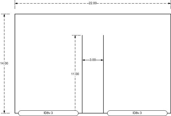

Here's my first stab. The only dimension not listed is the height. I figured it would be 10" tall. Close?
Help design ported box -- posted image.

Your design is too large.  If each sub wants 0.6 cuft ported enclosure you'll want to change the depth on the above design to something closer to 10" rather than 14".  Those subs are actually more suited to use in a sealed enclosure around 0.4 cuft.

I thought I was at about 1.2 cuft combined for this box which seems right for .6 ea.. You say these would be much better off sealed? I'm trying to get as much spl out of these 8's as possible because it'll be in boat.

Take your inner dimenasion length X width X height and divide that by 1728 to get cubic feet.  Your design is roughly 22 X 14 X 10 = 3080 cubic inches, divided by 1728 = 1.78 cubic feet.  If your number are outer measurements, assuming you use 3/4" MDF then you are much closer at 1.26 cuft.  According to the Image Dynamics web site these subs are designed for sealed enclosures, but using them vented is an option as long as you do not overpower them.  The difference in SPL is shown on the page you linked and is the peak around the tuning frequency.

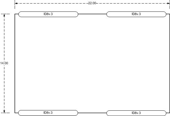

Just a random thought. Could I do 4 of these ID 8's (2 back to back) in a sealed enclosure? Would that blow away the 2 ported 8's on the spl side? Can you have subs back to back like this? I have a Hifonics Brutus BX1500D that I need to use for these so it seems like I have enough power.

No way, Jose.  Keep all the subs facing the same direction.

what if i put a wall between the 2 sets. i suppose that would work, right? 4 sealed 8's better then the 2 ported?
